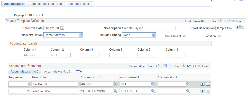

Use the Accumulators page (GPHK_PSLP) to set up delivery and print exclusion options, column headings (labels), and column contents (rows of accumulators).
Image: Accumulators page
This example illustrates the fields and controls on the Accumulators page. You can find definitions for the fields and controls later on this page.
Accumulators page
Note: Select the tabs that are in the scroll area to access additional views of this page. Fields that are common to all views are documented first.

Accumulator Labels
Enter the column heading labels for the accumulators that appear across the page on the printed payslip.
Accumulators 1 to 3 Tab
Access the Accumulators 1 to 3 tab.
Field or Control
Definition
Sequence
Enter a sequence number to set the order in which the accumulators appear. They appear in ascending order.
Description
Enter a description of each accumulator row.
Accumulator 1, Accumulator 2, and Accumulator 3
Select the accumulators to display for the corresponding column. Accumulator 1 values appear under the column 1 label, accumulator 2 values appear under the column 2 label, and so on.
For example, you might have already have entered a description of sequence 1 and 2 as current and year to date. If you also want to display quarter-to-date accumulated amounts, you must create a new row, give the new row the description value of QTD, and select the accumulators that correspond to the column headings (labels).

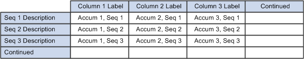

Accumulators on Printed Payslips
Image: Columns and rows on the payslip in the Pay Summary region
The following diagram shows how column labels, sequences descriptions, and accumulator numbers work together on the printed payslip:

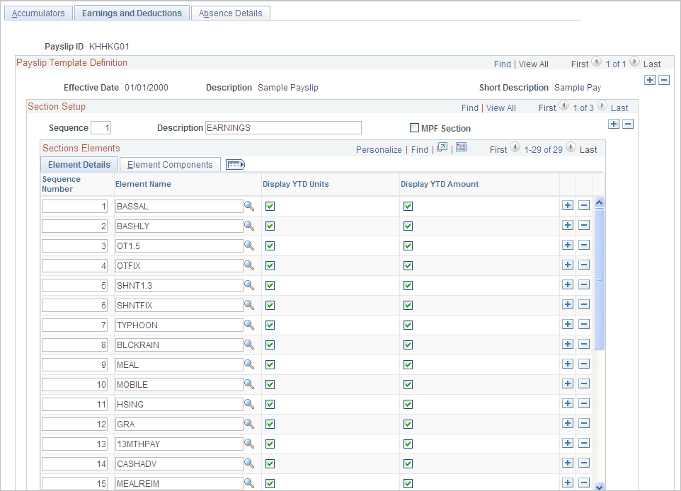

Use the Earnings and Deductions page (GPHK_PSLP1) to create sections of earnings and deductions, select from three description options, and set the element components (from the calculation rule) that the payslip displays.
Image: Earnings and Deductions page: Element Details tab
This example illustrates the fields and controls on the Earnings and Deductions page: Element Details tab. You can find definitions for the fields and controls later on this page.

Element Details Tab
Access the Element Details tab.
Field or Control
Definition
Display YTD Units (display year-to-date units) and Display YTD Amount (display year-to-date amount)
Select these check boxes to have the year-to-date units and amounts for each element appear in the payment details region under the heading Year to Date Values.

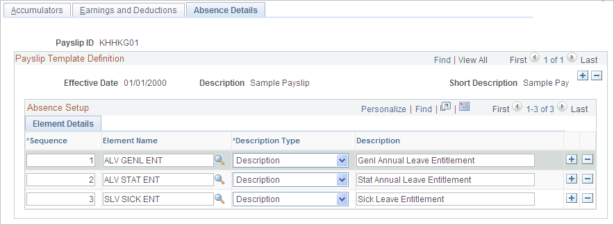

Use the Absence Details page (GPHK_PSLP2) to add absence entitlements and absence pro rata elements.
The payslip displays the current balance of the entitlement or pro rata.
Image: Absence Details page
This example illustrates the fields and controls on the Absence Details page. You can find definitions for the fields and controls later on this page.
Select the absence elements to display in the absence section of the payslip and the sequence in which these elements appear.
Use this page the same way that you use the Earnings and Deduction page. Enter a sequence number and an element name, and select one of three descriptions.
