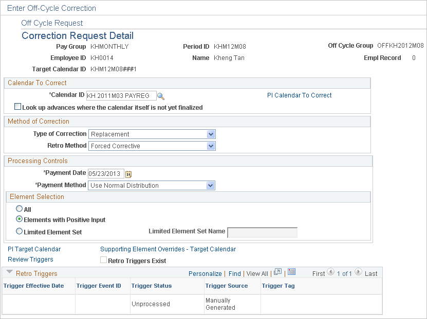

Note: When you create an Off Cycle Request, set the Positive Input to PI Calendar To Correct, and set the Retro Method to Forced Corrective.

Image: Correction Request Detail page
This example illustrates the fields and controls on the Correction Request Detail page. You can find definitions for the fields and controls later on this page.
Select this link and identify the pay period to correct.
Retro Method
Select the Forced Corrective option to use the corrective retro calculation method.
