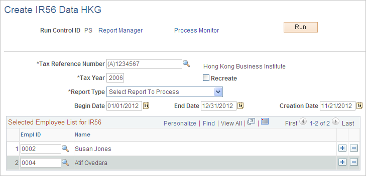

Use the Create IR56 Data HKG page (GPHK_IR56_CREATE) to run the process that captures information required for generating IR56 data and reports. After the process is initiated, the system identifies eligible employees and retrieves the information required for reporting.
Image: Create IR56 Data HKG page
This example illustrates the fields and controls on the Create IR56 Data HKG page. You can find definitions for the fields and controls later on this page.

Tax Reference Number
Select the tax reference number representing the pay entity (or entities) for which the IR56 must be generated. IR56 reports all run by tax reference number, which has a major impact on the way the system creates and stores IR56 data. For every employee attached to the pay entity (sharing the tax reference number), the system combines amounts for each year to date element by currency code and stores them in the IR56 result tables. After the process is completed, you can use the IR56 Monetary Details page to enter adjustments to reflect the amount that should be reported on the IR56 documents.
Tax Year
Enter the period for which the report must be reported. Hong Kong has set the tax period to be April 1 to March 31. Enter the year with 4 digits (for example, 2006).
Note: Although the tax year is not required for the IR56G and IR56F reports, you must still enter it.
Recreate
When you run the IR56 generation process for the first time, the value of this field does not matter. Data is generated for the selected employees or all eligible employees of the pay entity.
When you initiate the process again with the same parameters, the Recreate check box determines the following:
If you select the check box:
  • Employees (records in the IR56 table) that belong to the select group are deleted if the document created earlier has not been issued. Manual changes or information entered on the employee record using the IR56 Inquiry component are retained and included in the new record created for the employees.
  • If employees have been issued the respective document, a new employee record is generated on top of the existing one. The newly created record is identified as a replacement record. Manually entered information in the earlier version is copied into the new record.
If you deselect the check box, records are generated for the select group only if they don't already have a record existing. The record created is identified as an original record.
Note: The select group is the employee list entered on the run control page or the employees that are selected based on the criteria entered on the run control page for a specific pay entity.
Begin Date and End Date
These fields are required for the IR56F, IR56G, and IR56E reports. They enable you to narrow down the criteria of employee for whom the report should be generated. The begin and end dates are the tax period for which the employee received a particular amount.
For an IR56F, employees whose termination dates occur during the specified date range are selected.
For an IR56G, employees whose departure dates from Hong Kong occur during the specified date range are selected.
For an IR56E, employees whose hire dates occur during the specified date range are selected.
Unlike the IR56B and IR56M reports, in which balances for employees must be retrieved as of the end of the year, balances in this case are retrieved as of the period end date. The process identifies the last finalized pay calendar that is closest to the period end date and retrieves the balances for reporting.
Selected Employee List for IR56
Field or Control
Definition
EmplID (employee identification)
You can initiate the data creation process for a specific set of employees by selecting one or more employees.
Although you can select an employee ID, the process still decides if an employee is eligible to receive the selected IR56 document. For example, if you are running the process to create IR56B and you select an employee who has been terminated, the process ignores this employee.
