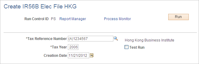

Use the Create IR56B Elec File HKG page (GPHK_IR56_EFILE) to create a flat file that complies with Hong Kong Inland Revenue Department requirements for the submission of electronic files.
Image: Create IR56B Elec File HKG page
This example illustrates the fields and controls on the Create IR56B Elec File HKG page. You can find definitions for the fields and controls later on this page.
Field or Control
Definition
Tax Reference Number
IR56 reports run by tax reference number, which has a major impact on the way the system creates and stores IR56 data. For every employee attached to the pay entity (sharing the tax reference number), the system combines amounts for each year to date element by currency code and stores them in the IR56 result tables. After the process is completed, you can use the IR56 Monetary Details page to enter adjustments to reflect the amount that should be reported on the IR56 documents.
Tax Year
Displays the period for which the report must be created. Hong Kong has set the tax period to be April 1 to March 31.
Note: Although the tax year is not required for the IR56G and IR56F reports, you must still enter it.
Test Run
Select this check box to create (but not send) the electronic file, so that you can view and check your data. When selected, employee records are not marked as sent and the supplementary status is not applicable.

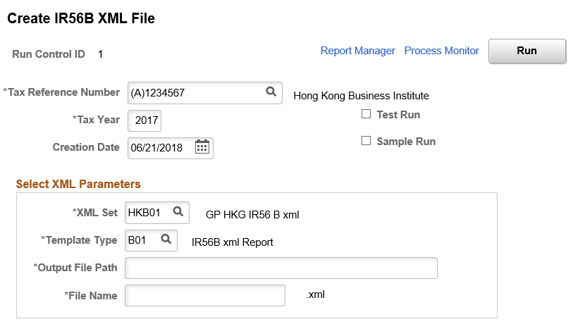

Use the Create IR56B XML File HKG page (GPHK_IR56_EFILE) to create an XML file that complies with Hong Kong Inland Revenue Department requirements for the submission of electronic files.
Image: Create IR56B XML File HKG page
This example illustrates the fields and controls on the Create IR56B XML File HKG page. You can find definitions for the fields and controls later on this page.
Field or Control
Definition
Select the Tax Reference Number.
Tax Year
Test Run
Sample Run
Select this check box to run a sample electronic file, so that you can view and check your data.
XML Set
Select the name of the XML set table.
Template Type
Select the name of the template type of the XML report to be generated.
Output File Path
Specify the directory where generated XML files are stored. This directory needs to have the right permission for file storage, and is required if the selected output type is File.
File Name
Enter the name of the file to be generated.
