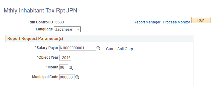

Use the Mthly Inhabitant Tax Rpt JPN (GPJP_RC_IH_MNTH) page which provides the number of inhabitant tax collections and the total amount collected for each municipality for each pay period.
Image: Mthly Inhabitant Tax Rpt JPN page
This example illustrates the fields and controls of the Mthly Inhabitant Tax Rpt JPN page.
Field or Control
Definition
Municipal Code
Use the field to prompt and show the Payment Municipal Code.
After payroll is finalized and appropriate adjustments are made, run processes (Load IH Tax Payment Data JPN, Maintain IH Tax File Data JPN and Create IH Tax File JPN) that create a banking file that summarizes inhabitant tax amounts sorted by municipal government. The municipal code used here is now Payment Municipality Code.

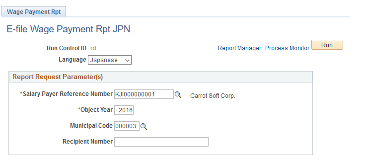

Use the E-file Wage Payment Rpt JPN process to retrieves each employee's Reporting Municipality Code based on Municipal Code (that is Payment Municipality Code) of the employee.
Image: E-file Wage Payment Rpt JPN page
This example illustrates the fields and controls of E-file Wage Payment Rpt JPN page.
Note: The wage summary payment report and the wage payment paper report will have order by on reporting municipal code, The Wage Payment summary Report will show Reporting Municipal codes in the Report.
The changes to the wage payment report as part of My Number Act implementation are as follows:
  1. Employee personal Number is displayed on the report.
  2. Count of dependents, count of disabled dependents, count of non-resident employees.
  3. List of dependents (Maximum count = 4) with their person number along with the non-resident flag circled.
  4. If the count of dependents is more than four, the remaining dependents (non-juvenile) name along with text non resident (if the dependent is a non-resident) is displayed in the section above insurance values and Person number is displayed to the right of juvenile dependents section
  5. If the count of Juvenile dependents is more than 4, the remaining dependents'(juvenile) name along with text "non resident" (if the dependent is a non-resident) is displayed in the section above insurance values and Person number is displayed to the right of juvenile dependents section below the Person numbers of the EXTRA Non-Juvenile Dependents.
