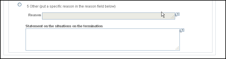

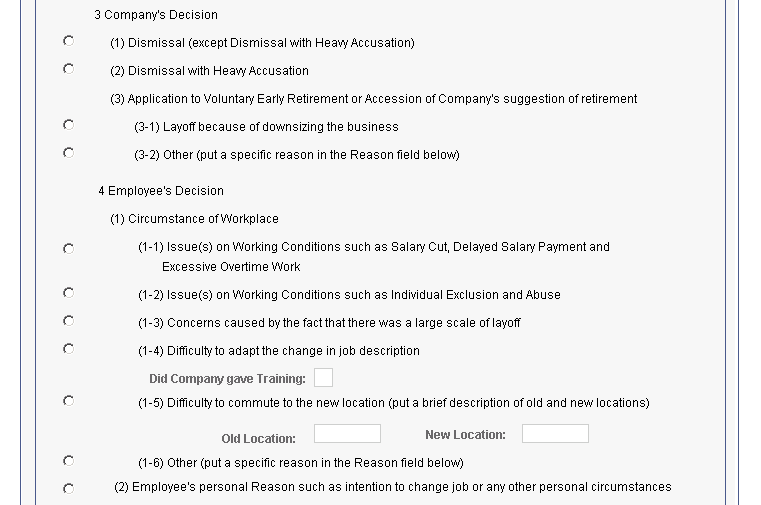

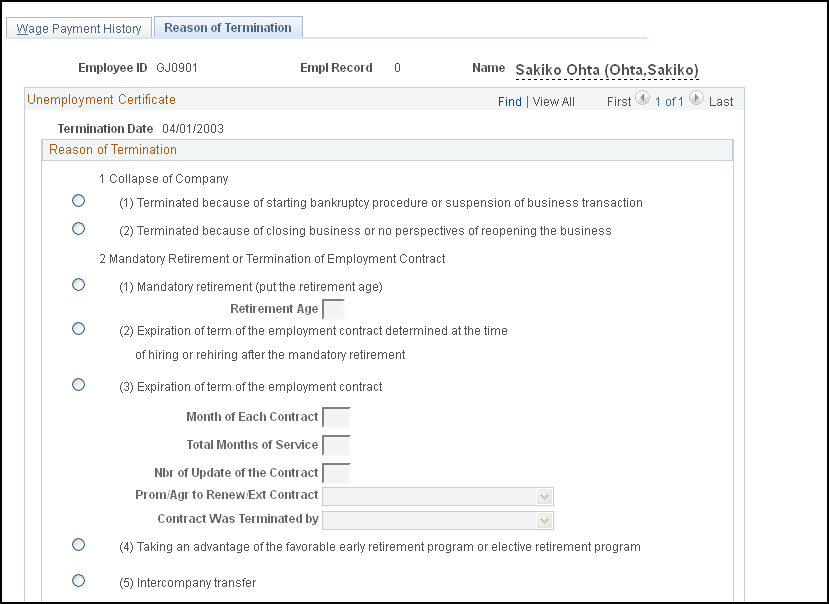

Use the Reason of Term (reason of termination) page (GPJP_UC_RSN_TERM) to enter and view information about reason of termination.
Navigation
Image: Reason of Term page (1 of 3)
This example illustrates the fields and controls on the Reason of Term page (1 of 3). You can find definitions for the fields and controls later on this page.
Image: Reason of Term page (2 of 3)
This example illustrates the fields and controls on the Reason of Term page (2 of 3). You can find definitions for the fields and controls later on this page.
Image: Reason of Term page (3 of 3)
This example illustrates the fields and controls on the Reason of Term page (3 of 3). You can find definitions for the fields and controls later on this page.

| Termination Date |
Displays the date that the employee was terminated. |
| Reason of Termination |
Select the reason for termination. Values are Collapse of Company, Mandatory Retirement or Termination of Employment Contract, Company's Decision, Employee's Decision, and Other. Depending on what you select, you may need to define the reason with more detail. |
| Reason |
If you select a termination reason or 3. (3–2), 4. (1)(1.6), or 5, you can enter a description of the specific reason. |
| Statement on the situations on the termination |
Add a statement about the termination, if necessary. |
