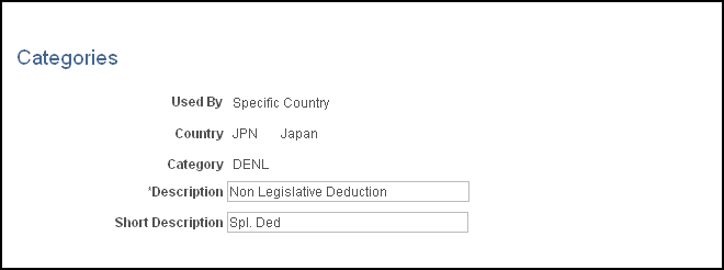

Use the Categories page (GP_PIN_CATEGORY) to set up or use an existing category for Zaikei deduction elements.
Image: Categories page
This example illustrates the fields and controls on the Categories page. You can find definitions for the fields and controls later on this page.
Categories page
Define the category type for the Zaikei elements as a prerequisite to defining Zaikei deduction elements.

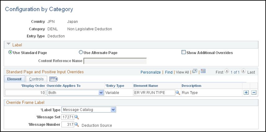

Image: Configuration by Category page - Element tab
This example illustrates the fields and controls on the Configuration by Category page - Element tab. You can find definitions for the fields and controls later on this page.
The Variable ER VR RUN TYPE holds the name of the run type that the user selects. The generation control formula ZK GC RUN TYPE FLG compares this value with the RUN TYPE system element to determine whether to process the deduction.

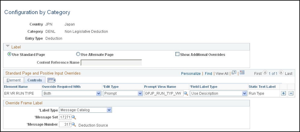

Image: Configuration by Category - Controls tab
This example illustrates the fields and controls on the Configuration by Category - Controls tab. You can find definitions for the fields and controls later on this page.
The GPJP_RUN_TYP_VW prompt view enables the user to select Japan-specific run types, either SAL (Salary) or BON (Bonus) based on the sample data.

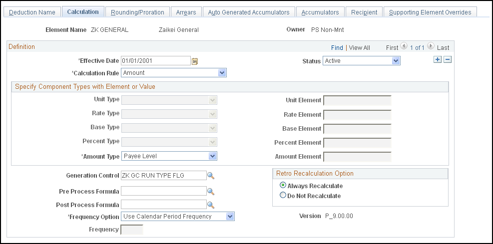

Use the Calculation page (GP_ERN_DED_CALC) to for Zaikei deductions, enter the effective date of the deduction, set the Calculation Rule option to Amount, and set the Amount Type option to Payee Level.
Image: Calculation page
This example illustrates the fields and controls on the Calculation page. You can find definitions for the fields and controls later on this page.
Calculation page
The field entries on this page are the same for all Zaikei deduction elements that you create.
Field or Control
Definition
Calculation Rule
Select the Amount option.
Amount Type
Select the Payee Level option.
Generation Control
The generation control formula ZK GC RUN TYPE FLG determines whether to process the deduction based on the Run Type system element.

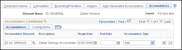

Use the Accumulators page (GP_ERN_DED_AC_ADDL) to specify the accumulator for Zaikei deductions.
Image: Accumulators page
This example illustrates the fields and controls on the Accumulators page. You can find definitions for the fields and controls later on this page.
Accumulators page
Field or Control
Definition
Accumulator Element
Enter ZK AC SAVINGS.
Accumulator Sign
Select the Add option.
Note: On the Contributions tab, the Percent Option is Numeric and the Percent to Accumulate field entry is 100.000000.
