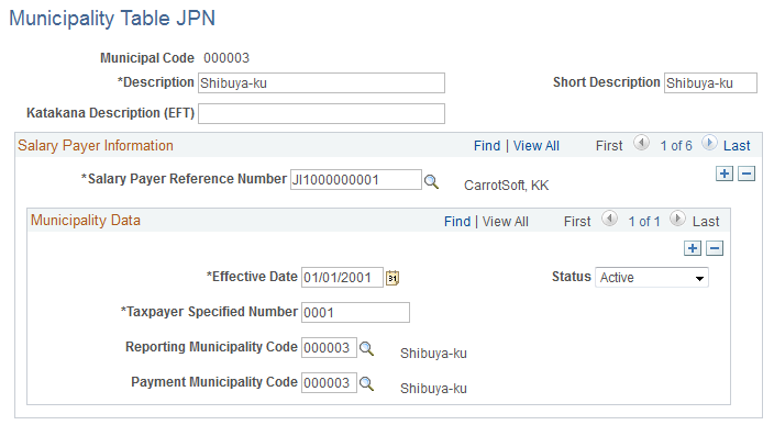

Use the Municipality Table JPN page (GPJP_IH_MUNIC) to define municipality codes and associate them with salary payers.
For each salary payer, record the taxpayer-specified number assigned by the municipality.
Image: Municipality Table JPN page
This example illustrates the fields and controls on the Municipality Table JPN page. You can find definitions for the fields and controls later on this page.

Salary Payer Reference Number
Select each income tax establishment associated with this municipality.
Taxpayer Specified Number
Enter the number assigned by the municipality to the salary payer for special collection.
Reporting Municipality Code
Enter the reporting municipality code where the wage payment report to be sent.
Payment Municipal Code
Enter the municipal code where the inhabitant tax should be paid.

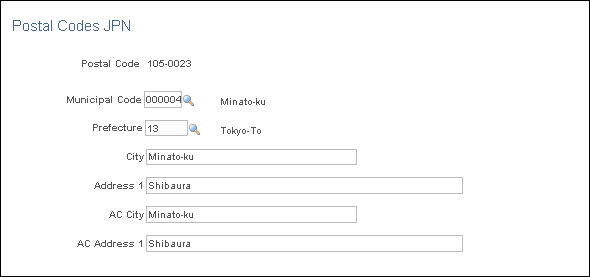

Use the Postal Codes JPN page (POSTAL_TBL_JPN) to associate municipality codes with postal codes.
Image: Postal Codes JPN page
This example illustrates the fields and controls on the Postal Codes JPN page. You can find definitions for the fields and controls later on this page.

Municipal Code
Select the municipal code to associate with this postal code.
