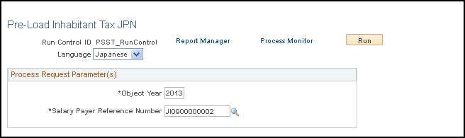

Use the Pre-load Inhabitant Tax JPN page (GPJP_RC_IH_MUN1) to update the municipality codes and recipient numbers by running the Pre-Load Inhabitant Tax process (GPJP_IHMUN1), which loads the employee, municipality, and recipient numbers for the object year into the Inhabitant Tax table.
Navigation
Image: Pre-Load Inhabitant Tax JPN page
This example illustrates the fields and controls on the Pre-Load Inhabitant Tax JPN page. You can find definitions for the fields and controls later on this page.
Field or Control |
Definition |
| Object Year |
The default is the current year. |
| Salary Payer Reference Number |
The process selects all employees who are reported to the municipality for the salary payer reference number that is entered here. |
