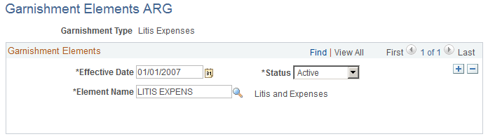

Use the Garnishment Elements ARG page (GPAR_GARN_PIN) to define the element associated with each garnishment type.
Image: Garnishment Elements ARG page
This example illustrates the fields and controls on the Garnishment Elements ARG page. You can find definitions for the fields and controls later on this page.
Field or Control
Definition
Element Name
Select the name of the element used to deduct the garnishment during the payroll calculation process. Valid values are deductions with the EMB category
