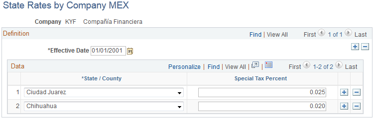

Use the State Rates by Company MEX page (GPMX_SPST_TAXES) to define state and local taxes at the company level.
This only applies to companies operating in Chihuahua and/or Ciudad Juarez.
Image: State Rates by Company MEX page
This example illustrates the fields and controls on the State Rates by Company MEX page. You can find definitions for the fields and controls later on this page.

State/County
Select Chihuahua, Ciudad Juarez, or Hidalgo.
Special Tax Percent
Enter the state tax rate for your company.
Note: Chihuahua is the only state in Mexico that taxes a company's earnings based on the number of employees it has, so the state tax rates vary for each company.
It's difficult to determine the number of employees in a company before the payroll process, so you must determine the number of employees in your company and then the corresponding tax rates for your company individually.
You'll also define local tax rates for Ciudad Juarez on this page. The local tax rate varies depending on the amount of minimum wages of the entire payroll earnings in a month. This information can also be difficult to determine prior to running a payroll. Therefore, you can load this data into the payroll process with the IE AR ES CIA array.
