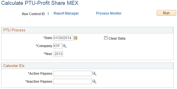

Use the Calculate PTU-Profit Share MEX page (GPMX_RC_PTU001) to run the PTU process.
Image: Calculate PTU-Profit Share MEX page
This example illustrates the fields and controls on the Calculate PTU-Profit Share MEX page. You can find definitions for the fields and controls later on this page.
The PTU process generates two instances of positive input: one for the PTU IMP SAL element, and the other for the PTU IMP DIAS element. The PTU process also calculates the Day Factor and Salary Factor values that will be inserted in the PTU Setup page.
PTU Process
Enter the date, company, and year for which you want to run the process.

Clear Data
If you select this check box, the system will delete previously loaded data. If you deselect this check box, the PTU process will load new data into the Calendar IDs for active and inactive payees.
Calendar IDs
Field or Control
Definition
Active Payees
Enter the calendar ID of the active payees to process. The electronic file transfer (EFT) for active payees will be as usual.
Inactive Payees
Enter the calendar ID of the inactive payees to process. The most common way to pay inactive payees is on an individual basis. Once the PTU process is executed, you can create a Period ID, Calendar ID, and Calendar Group ID to run the payroll process.
