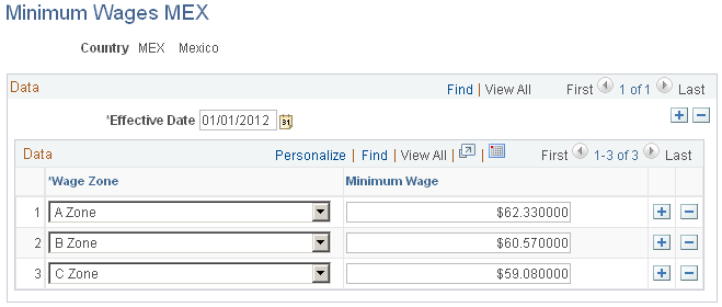

Use the Minimum Wages MEX page (GPMX_MIN_WAGE) to define minimum wages for each wage zone.
You can update this page as minimum wage rates change.
Image: Minimum Wages MEX page
This example illustrates the fields and controls on the Minimum Wages MEX page. You can find definitions for the fields and controls later on this page.
Field or Control
Definition
Wage Zone
Enter the wage zone. Values are A Zone, B Zone, and C Zone.
Minimum Wage
Enter the minimum wage for the wage zone.
The minimum wage in Mexico is determined as a daily amount, not an hourly amount. For example, in A Zone, the minimum wage for the year 2004 is 45.24 MXN (per day). Minimum wages are used in determining several earnings caps such as vacation premium caps and Sunday premiums. For example, the law states that the non-taxable base for a Sunday premium will be equal to one daily minimum wage rate.
Note: Because minimum wage amounts usually change from year to year, you can update this table by adding a new effective-dated row.

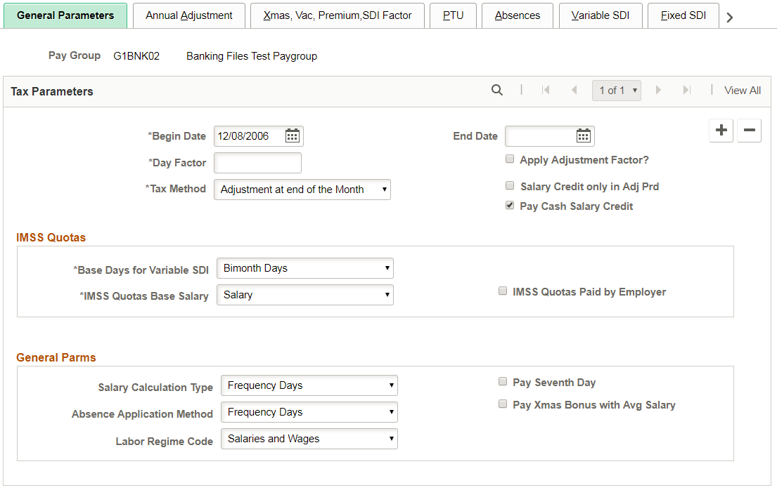

Use the General Parameters page (GPMX_TAX_PARM) to define general parameters for federal taxes and IMSS quotas.
Image: General Parameters page
This example illustrates the fields and controls on the General Parameters page. You can find definitions for the fields and controls later on this page.
Tax Parameters
These fields apply to federal tax processing.
Field or Control
Definition
Day Factor
If you select the Apply Adjustment Factor check box, enter the day factor. Values are 30 or 30.4, in most cases. The value you select corresponds to the monthly taxable base.
Apply Adjustment Factor?
Select if your company adjusts the payroll for federal taxes. For example, federal taxes in Mexico are due monthly, but let's say that your company has a semimonthly payroll. So, you will divide the number of days so that it's adjusted for the monthly federal taxes.
Note: Day Factor andApply Adjustment Factor are only used to calculate federal taxes.
Salary Credit only in Adj Prd (adjustment period)
Select if you're going to give a subsidy or salary credit to an employee only in an adjustment period (usually the last period of each month).
Note: This field does not appear on the page when the value of the Begin Date field is01/01/2008 or later.
Pay Cash Salary Credit
Select to indicate that the Cash Salary Credit will be paid on a separate payslip (if a separate payroll is run). If you select this check box, the Cash Salary Credit will not appear in an employee's regular payslip.
Note: This field does not appear on the page when the value of the Begin Date field is 01/01/2008 or later.
Tax Method
Select the method used for calculating the month to month tax deduction. The tax methods you can choose from are:
Adjustment During the Month, Adjustment at end of the Month, Annual Projection Method, Semi-monthly Projected and Without Adjustment.
Subsidy Method
Enter the subsidy method. The subsidy methods you can choose from are:
Adjustment During the Month, Adjustment at end of the Month, Payment in the Last Period, and Without Adjustment.
IMSS Quotas
These fields apply to social security setup.
Field or Control
Definition
Base Days for Variable SDI
Select the method you'll use for calculating the variable portion of SDI. Values are 60 Days, Bimonth Days, Hourly Payee, and Paid Days. For example, when you select 60 Days, the system always uses 60 days (minus the number of days that the payee was not active) no matter what bimonthly period the system is calculating. If Bimonth Days is selected, then the number of days considered depends on the bimonthly period processed (61 days for the second bimontly period). Paid Days is for payees who do not work on a regular basis. Hourly Payee is for payees whose payment is based on hours worked instead of days worked.
IMSS Quotas Base Salary
Helps to determine if you should pay IMSS quotas for workers with minimum wages by comparing the Minimum Wage to the SDI or Daily Salary. Values are SDI and Salary.
IMSS Quotas Paid by Employer
Some companies pay employees' IMSS quotas. If you select this check box, it helps determine whether your company should subtract the IMSS quotas from the employee's earnings or not.
Note: You'll select the IMSS Quotas Paid by Employer check box if the employee quotas will not be deducted from the net pay of the employee. You'll also define which salary type the system will compare to the minimum wage (either the Daily Salary or the SDI) in theIMSS Quotas Base Salary field. Although the law states that employers do not need to withhold IMSS quotas for employees with minimum wages, some companies compare the SDI versus the minimum wage instead of the Daily Rate versus the minimum wage to decide if they're going to withhold IMSS quotas for employees with the minimum wage. In Global Payroll for Mexico, you have the choice of how you want to define your IMSS quotas for employees earning minimum wages.
General Parms (parameters)
Field or Control
Definition
Salary Calculation Type
Values are Calendar Days, Frequency Days, and Hourly. If you select Calendar Days, the salary base will be calculated based on the days of the calendar. If you select Frequency Days, the salary paid will be calculated according to the days being processed in the period. If you select Hourly, the pay will be calculated for the hours entered at the payee level.
Absence Application Method
Select how you want the system to determine the number of days to be considered for absence calculations in a given calendar period for monthly and semimonthly payrolls. If you select Calendar Days, then the system uses the number of calendar days (28, 29, 30, or 31) depending on the month that is being processed. If you select Frequency Days, then the system uses 30 as the upper limit for the number of days to be considered for a given month.
Labor Regime Code
Select the Labor Regime Code. Valid values are:
  • Income Stock or Bond
  • Members of Council Directors
  • Pensioners
  • Retirees
  • Salaries and Wages
  • Salary and Serv Fees Assim
  • Severance
  • Similar Others
  • Similar to Salary Business Act
  • Similar to Salary Civil Associ
  • Similar to Salary Cooperative
Pay Seventh Day
Select if workers should be paid for the seventh day in a week. This field is commonly used for union purposes. If you select this check box, it will trigger an earning to separate regular earnings from the seventh day earnings.
Pay Xmas Bonus with Avg. Salary
In Mexico, it's common for employees to receive their Christmas bonus with the daily rate. However, some employees may receive commission or other additional pay. In these cases, the Christmas bonus can be paid by the sum of the daily salary, which results in the average salary. If this situation applies for a pay group, select this check box.

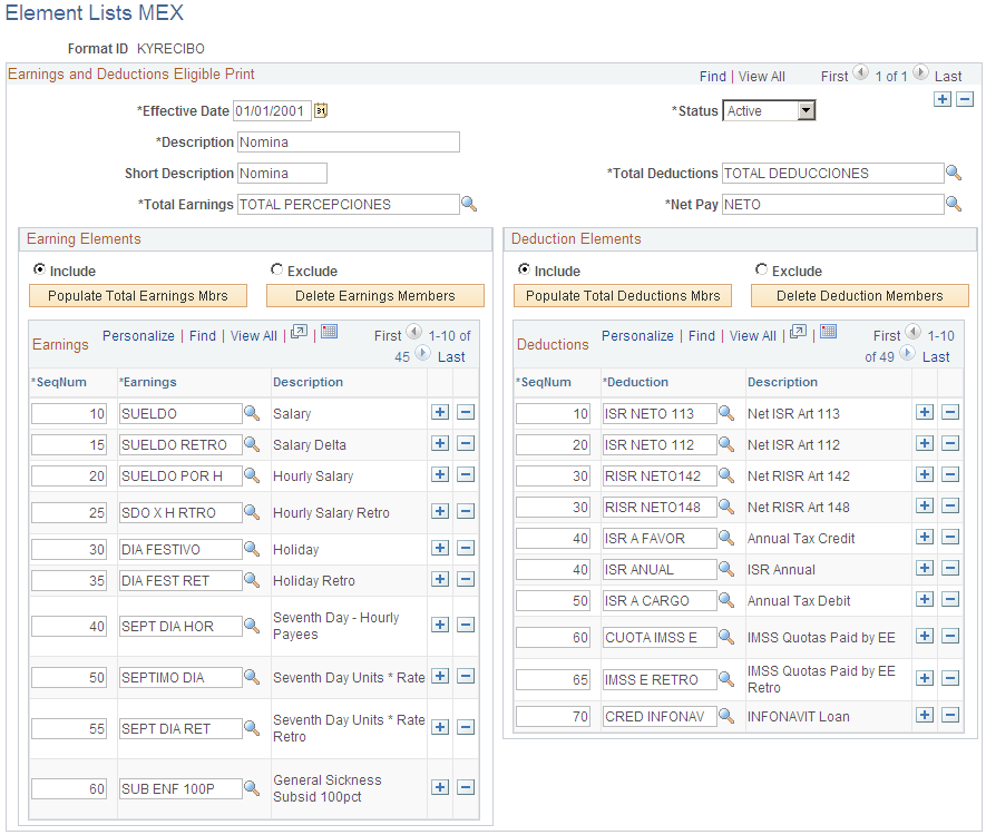

Use the Element Lists MEX page (GPMX_PAYSLIP_FORMA) to enter the earnings and deductions that are eligible to print on a payslip.
Element lists are used in the payroll results register and in termination/layoff letters, as well as the payslip generation process.
Image: Element Lists MEX page
This example illustrates the fields and controls on the Element Lists MEX page. You can find definitions for the fields and controls later on this page.
Earnings and Deductions Eligible Print
Field or Control
Definition
Total Deductions
Select the element that corresponds to total deductions.
Total Earnings
Select the element that corresponds to total earnings.
Net Pay
Select the element that corresponds to net pay.
Earning Elements
Field or Control
Definition
Include/Exclude
You can choose to enter the earnings you want included on the payslip or you can choose to enter the earnings you want excluded, depending on what is the easiest way for you to define your payslips. For example, if you have defined 20 types of earnings and you only want to include 5 of them, the easiest way is to include those 5 earnings, instead of excluding the other 15 earnings. On the other hand, if you want to exclude only 3 earnings from the payslip, you can select Exclude and then enter the 3 earnings that you want to exclude, instead of including the other 17 earnings.
Populate Total Earnings Mbrs (members) andPopulate Total Deductions Mbrs (members)
If you click this button, all the earnings and deductions that contribute to the selected accumulator will be populated.
Deduction Elements
The fields on the Deductions Elements group box are similar to the fields on theEarnings Elements group box.
Earnings
Field or Control
Definition
SeqNum (sequence number)
Enter the sequence number for the earnings.
Earnings
Select the individual earnings elements that will be included (or excluded) in the payslip.
Deductions
The fields on the Deductions group box are similar to the fields on theEarnings group box.

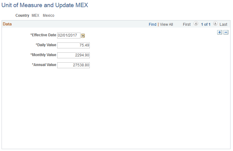

Use the Unit of Measure and Update MEX page (GPMX_UMA_VALUES) to define Unit of Measure.
Note: UMA is the economic reference in Mexican Pesos to determine the amount of the payment the obligations and assumptions provided for the federal laws. This amount will be updated every year by the Government Institution (INEGI).
Image: Unit of Measure and Update MEX page
This example illustrates the Unit of Measure and Update MEX page.
The monthly value of the UMA is calculated by multiplying its daily value by 30.4 times and its annual value is calculated by multiplying its monthly value by 12.

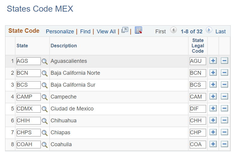

Use the State Code MEX page (GPMX_STATE_LGL) to map People Soft States with the Legal Codes Mexican states (tags) provided by the SAT.
Image: State Code MEX Page
This example illustrates the State Code MEX page.
States Code Mex Page
Field or Control
Definition
State
Select a state code. Sates code are stored in the STATE_TBL table in PeopleSoft
State Legal Code
Enter 3 characters SAT legal codes to map to the select State code.
Note: The State Legal code is printed in the tag ClaveEntFed in the CFDI file.

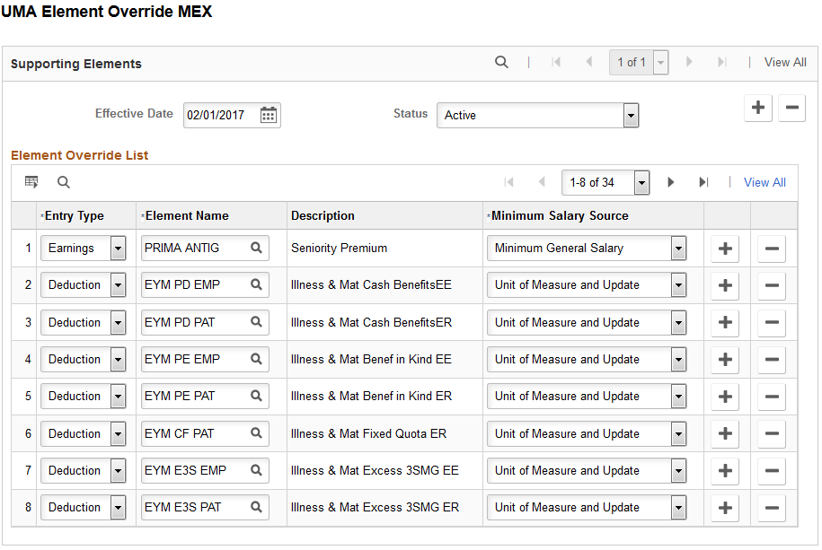

Use UMA Element Override MEX page (GPMX_UMA_SOVR) to define element overrides.
Image: UMA Element Override MEX Page
This example illustrates the fields and controls on the UMA Element Override MEX Page.
Field or Control
Definition
Effective Date
The date from which the defined element overrides are applicable.
Status
Status is Active and Inactive for the performance of this page
Entry Type
Define the type of input that will be override to the elements of the system.
  • Earnings
  • Deductions
  • Formula
  • Bracket
  • Auto Assigned
  • System Element
  • Variable
Element Name
Name of the element that the company uses to pay or discount the income of employees.
Description
Based on selected Element Name, description is populated.
Minimum Salary Source
The value to be used to override the selected element. Valid values are:
  • Minimum Wage
  • Unit of Measure and Update

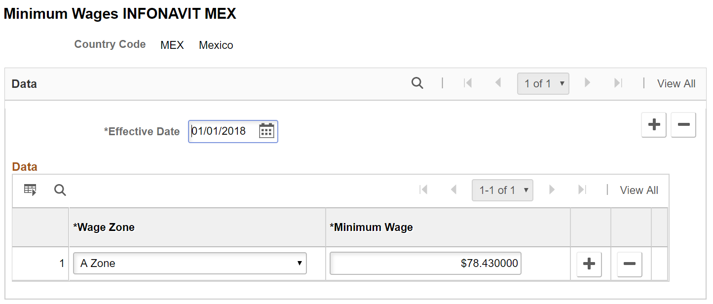

Use the Minimum Wages Infonavit MEX page (GPMX_MIN_WAGE_INF) to capture the minimum wage for INFONAVIT. This can be used in other system elements as earnings, deductions, formulas, variable, Accumulators and Auto Assign.
Image: Minimum Wages Infonavit MEX page
This example illustrates the fields and controls on the Minimum Wages Infonavit MEX page.
Field or Control
Definition
Effective Date
The date from which the Minimum Wage is effective.
Wage Zone
Select the wage zone. Available options are:
  • A Zone
  • B Zone
  • C Zone
Minimum Wage
Enter the minimum wage INFONAVIT for the selected wage zone.
