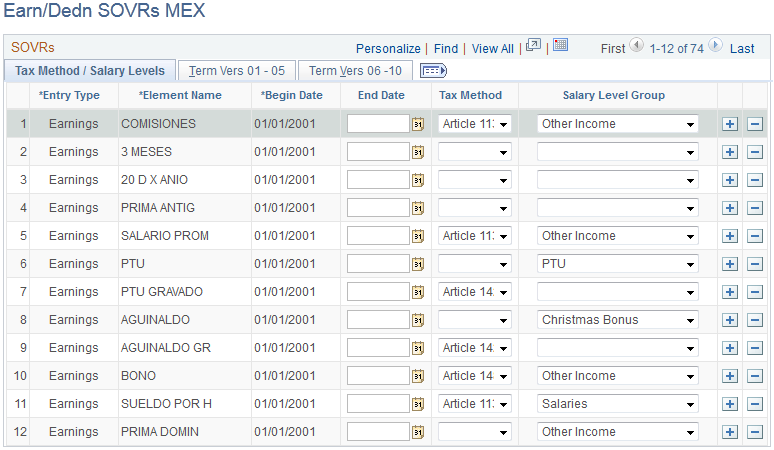

Use the Earn/Dedn SOVRs MEX (Earnings/Deductions SOVRs MEX) page (GPMX_ERNDED_SOVR) to set up SOVRs at the earnings and deduction level for variables used in key calculations.
Image: Earn/Dedn SOVRs MEX page
This example illustrates the fields and controls on the Earn/Dedn SOVRs MEX page. You can find definitions for the fields and controls later on this page.
Tax Method/Salary Levels Tab
Field or Control
Definition
Entry Type
For a Minimum Wage Salary Level report: Define the type of element to include in the report. You can include only earnings or deductions.
For tax method selection: Define the type of element to which you want to apply a tax method using the Tax Method field. You can include only earnings or deductions.
Element Name
For a Salary Level report: Enter the name of the earnings or deductions element to include in the Minimum Wage Salary Levels report (report GPMXAA01).
For tax method selection: Enter the name of the earnings or deductions to which you want to apply a tax method using the Tax Method field.
Begin Date
Enter the begin date of the supporting element override.
End Date
Enter the end date of the supporting element override.
Tax Method
Define the tax method to apply to each earnings and deduction identified in the Entry Type andElement Name fields.
Salary Level Group
For a Minimum Wage Salary Level report, specify the salary level group in which you want to include the earnings or deductions identified in the Element Name field.
Term Vers 01-05 and Term Vers 06-10 Tabs
Field or Control
Definition
Term Vers 01-10 (termination versions 1-10)
This field is used to associate earnings and deductions with termination versions. For each earnings or deduction that you identify in the Entry Type andElement Name fields, specify the termination versions (the grouping of termination actions and reasons) for which the earnings and deductions can be paid. Select up to 10 different termination versions for each earnings and deduction.
