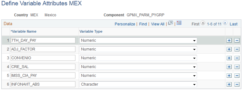

Use the Define Variable Attributes MEX page (GPMX_COMP_VARS) to define the component variables to be used on the Map Elems to Comp/Rcd MEX page when defining the variable type.
Image: Define Variable Attributes MEX page
This example illustrates the fields and controls on the Define Variable Attributes MEX page. You can find definitions for the fields and controls later on this page.
Field or Control
Definition
Variable Name
Enter the name of the variable. This can be any name you want to use during PeopleCode development.
Variable Type
Select the variable type. Values are Character, Date, and Numeric.
Note: Once you've defined your component variables, you can map your elements on the Map Elems to Comp/Rcd MEX page.
