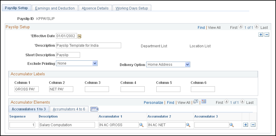

Use the Payslip Setup page (GPIN_PSLP) to set up delivery and print exclusion options, column headings (labels), and column contents (rows of accumulators).

Field or Control |
Definition |
| Payslip ID |
You can attach a single template, by its ID, to multiple pay groups. You can attach multiple templates to a pay group. Each template is used in conjunction with a particular run type. |
| Exclude Printing |
Select either Department orLocation to exclude departments or locations from the payslip print run. The corresponding link becomes active, so you can select from the department or location lists. You can override the exclusion on the Process Payslip page before you run the print program. Note: If you choose to enter a particular pay entity as the print option on the Process Payslip page and you have excluded a location that falls under that pay entity, it is not printed. |
| Delivery Option |
Select an address type to receive printed payslips. You can select Department orLocation to mail the payslip to an internal address, or you can selectHome Address orMail Address to send it to an external address as recorded on the payee's personal data record. You can override the selection made here on the Payslip Payee Override page, which is effective-dated; therefore, you can override the delivery option for a period of time if necessary. |
| Column 1 toColumn 6 |
Enter the labels that you want to appear across the page on the printed payslip as the column headings for the accumulators. These column labels appear in the payslip region under the region heading Pay Summary. |
Accumulators 1 to 3
Field or Control |
Definition |
| Sequence |
Enter a sequence number to set the order in which the accumulators appear. They appear in ascending order with the lowest number first. |
| Description |
Enter a description of each accumulator row. |
| Accumulator 1, Accumulator 2, andAccumulator 3 |
Select the accumulators that you want displayed for the corresponding column. For example, suppose you enter a description for sequences 1 and 2 as Current andYTD. If you also want to display quarter-to-date accumulated amounts, create a new row, give the new row the descriptionQTD, and then select the accumulators that correlate to the column headings. |
Accumulators 4 to 6
Field or Control |
Definition |
| Accumulator 4, Accumulator 5, andAccumulator 6 |
Select the accumulators that you want displayed for the corresponding column. No Sequence orDescription fields exist because the same sequence number and description applies to all six accumulators in the row. |

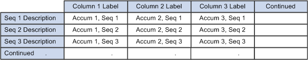

Printed Payslip Example
Image: Columns and rows on the payslip in the Pay Summary region
This diagram shows how column numbers, sequences, and accumulator numbers work together on the printed payslip:

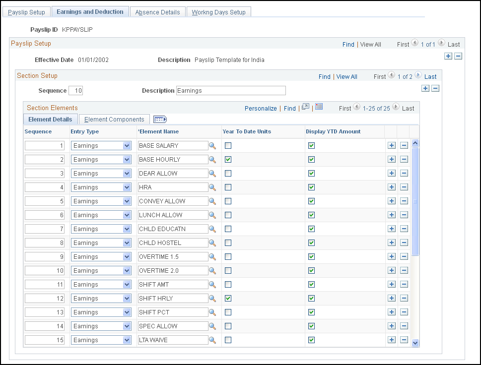

Use the Earnings and Deduction page (GPIN_PSLP1) to create sections of earnings and deductions, select from three description options, and set the element components that the payslip is to display.
Navigation
Image: Earnings and Deduction page
This example illustrates the fields and controls on the Earnings and Deduction page. You can find definitions for the fields and controls later on this page.
Section Setup
Field or Control |
Definition |
| Description |
Descriptions appear as section headings in the payslip region under the heading Payment Details. |
Element Details
Field or Control |
Definition |
| Year To Date Units andDisplay YTD Amount (Display Year to Date Amount) |
Select these check boxes if you want the year-to-date units and amounts for each element to appear in the Payment Details region under the heading Year to Date Values. |
Element Components
Field or Control |
Definition |
| Description Type |
Select one of three descriptions to appear for each earning or deduction row in the Payment Details region of the payslip. Values are: Custom: A text box appears for you to enter a description. Description: The element's description as entered on the element's name page in its component. Element Name: The element's name from its name page in its component. It also appears on the Elements Details tab. |
| Print Unit, Print Rate, Print Base, andPrint Percentage |
Select the components of the element's calculation rule that you want to show for each earning or deduction in the sections. You can select only the components in the element's calculation rule. For example, for an earning with a calculation rule of Unit Rate, only the Print Unit andPrint Rate check boxes are available for selection. Note: Amount always appears; therefore, it is not an option here. |

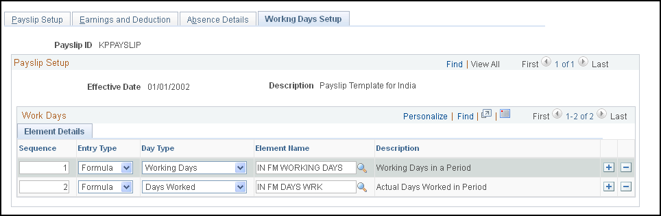

Use the Workng Days Setup page (GPIN_WORKDAYS) to set the element components for the number of scheduled working days and the number of actual days worked that the payslip displays.
Navigation
Image: Workng Days Setup page
This example illustrates the fields and controls on the Workng Days Setup page. You can find definitions for the fields and controls later on this page.
Field or Control |
Definition |
| Entry Type |
Define a row with an entry type of Count and a row with an entry type ofFormula. |
| Day Type |
For the row with an entry type of Count, define a day type ofWorking Days. For the row with an entry type ofFormula, define a day type ofDays Worked. |
| Element Name |
For the row with a day type of Working Days, select theGP WORK DAY COUNT element. For the row with a day type ofDays Worked, select theLOP FM DAYS element. |

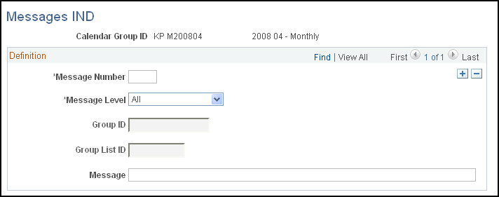

Image: Messages IND page
This example illustrates the fields and controls on the Messages IND page. You can find definitions for the fields and controls later on this page.
Field or Control |
Definition |
| Message Number |
This is the message ID that the system uses to get the right message for the right payees. Arrays, formulas, and variables combine to get the right message. |
| Message Level |
Select from the following values: All: All payees identified in the calendar group. Group Build: All payees included in a group that you build by using the Group Build feature in PeopleSoft HR. You can also access the group build pages through the navigation. If you select this option, enter a group in theGroup ID field. Group List: All payees in a list that you build by using the Global Payroll Group List feature. If you select this value, enter a group in theGroup List ID field. |
| Message |
Enter the text of the message to appear on selected payslips. |
