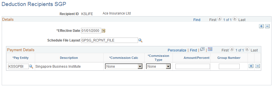

Use the Deduction Recipients SGP page (GPSG_RECIPIENT_EXT) to link an electronic file format to a provider and enter pay entity and commission payment details and your group ID with the provider.
Image: Deduction Recipients SGP page
This example illustrates the fields and controls on the Deduction Recipients SGP page.
Field or Control
Definition
Schedule File Layout
Select the appropriate file layout from those you have created in Application Designer for the electronic files you submit to your recipients
Pay Entity
Enter the pay entity that is going to receive any commission payable by the recipient. If the commission is to be deducted from the payment due to the recipient, the debit to this pay entities source bank will be reduced by the commission amount.
Commission Calc (commission calculation)
Select from Deduct Commission (payment) to have the amount deducted from the payment to be made to the recipient,None, orReport Only to report the amount of commission for later payment from the recipient back to the pay entity.
Commission Type andAmount/Percent
Select from Flat Amt (amount), None, orPercentage and enter the amount or percentage in theAmount/Percent field.
Group Number
Enter the ID the recipient has allocated to your pay entity, your "customer number" with them.

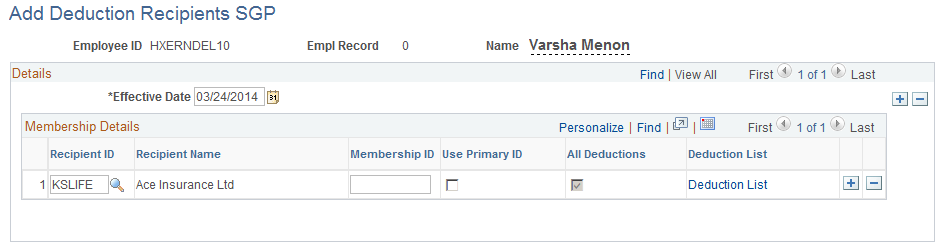

Use the Add Deduction Recipients SGP page (GPSG_RCPPYE_EXT) to link payee membership numbers to providers using the provider's recipient ID.
From this page, you can access the Deduction List page, where you enter the deductions to which a particular membership number belongs.
Image: Add Deduction Recipients SGP page
This example illustrates the fields and controls on the Add Deduction Recipients SGP page.
Field or Control
Definition
Membership ID and Use Primary ID
Enter the payee's membership number associated with particular recipients. If you select the Use Primary ID check box, the Membership ID field is unavailable for input. The Membership ID is retrieved from the employee's National ID Table (PERS_NID.NATIONAL_ID) during the EFT file creation process.
If the payee's Membership ID is the same number as their Primary ID, you can indicate this by selecting the Use Primary ID check box and leaving theMembership ID blank. You have the option to specify if that recipient ID/membership number combination is for all deductions or to designate specific deductions for that combination.
You can enter multiple Recipient ID/Membership ID combinations.
Deduction List and All Deductions
Click the Deductions List link to access the Deduction List page where you enter the deductions to which a particular membership number belongs. When you return from the Deduction List page, theAll Deductions check box is automatically updated and selected if you have entered specific deductions.
