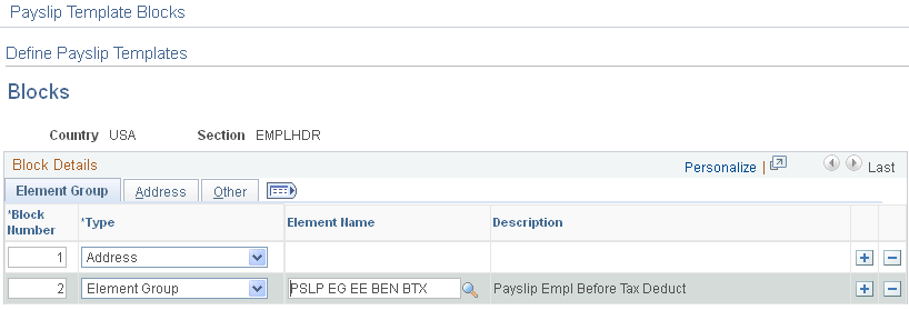

Use the Blocks page (GP_PSLP_TEMPL_SEC) to enter element group, address, or other information for the blocks of data in the section if the section requires this type of information.
Navigation
Select the Details link on the Define Payslip Templates page.
Image: Blocks page
This example illustrates the fields and controls on the Blocks page.
Note: Entering data on this page is optional and is a way for the functional user to communicate to the technical developer the type of information that should appear in the section on the printed payslip.
Field or Control |
Definition |
| Block Number |
Enter a number that is referenced in the payslip program section. Payroll administrators use block numbers to build payslips; therefore, the developer of the blocks should leave comments in the section definition for the administrator (visible from the template) to indicate which block numbers the developer coded and the content type of the blocks (element groups, addresses, and so on). For instance, a developer might code block number 10 for earnings, 20 for deductions, and 30 for leave balances. The developer should indicate that these block numbers refer to these types of data. |
| Type |
Select a type to determine the block content that can be entered. Valid values are Element Group, Address, and Other. |
| Element Name, Address Type Code and Other |
Depending on the type selected, enter the appropriate value. If the type is Element Group, enter an element group name in the Element Name field. If the type is Address, enter an address type in the Address Type Code field. If the type is Other, enter free-form text in the Other field. |
| Description |
Displays the description of the element name if Element Name was selected as the type. |
This table describes the content of the Blocks page based on the type entered:
Type |
Content |
Element Group |
Displays element groups that are members of the list set selected at the template level. |
Address |
Displays delivery location plus a list of address types defined in PeopleSoft HCM such as Home, Work, and Mailing Address. If the block in the payslip program calls for an address, the address selected here is the address that appears in the block. You must specify in the payslip program what address appears if the address selected in this block does not exist for the payee. |
Other |
Free-form text specified for each section. |
