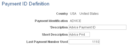

Use the Payment ID Definition page (GP_PYMT_ID_DEFN) to define a payment ID that is unique by bank account number.
Navigation
Image: Payment ID Definition page
This example illustrates the fields and controls on the Payment ID Definition page.
If you have two different bank accounts, you will have two different payment IDs for each bank account, for example, one for direct deposits and another for checks.
Field or Control |
Definition |
| Country |
Select the country that uses the payment ID. |
| Payment Identification |
Enter a unique definition for the payment ID. |
| Last Payment Number Used |
Enter the last payment number used for the payment identification. For example, the last number used for advices. Note: The last payment number determines the starting number for checks and advices during the payment process. |

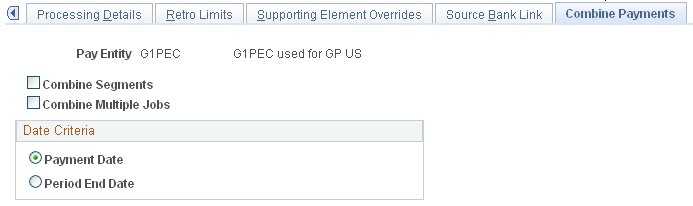

Use the Combine Payments page (GP_PYENT_COMB) to assign appropriate rules for combining payments and payslips to a pay entity.
Navigation
Image: Combine Payments page
This example illustrates the fields and controls on the Combine Payments page.
In PeopleSoft Global Payroll, an employee may have multiple segments generated for a given calendar group as a result of segmentation or multiple jobs. Each of these segments may produce a separate payment based on the employee's net pay elections. If you want an employee to receive a single payslip, use the Combine Payments page to control how payslips and payments are combined.
Field or Control |
Definition |
| Combine Segments |
Select if segments should be combined for banking and payslips. If you don't select this check box, all other options will be deselected and unavailable for entry. |
| Combine Multiple Jobs |
Select to combine multiple jobs into a single payment. |
Date Criteria
Use this group box to specify criteria for combining payments. You must select one of the two options.
Field or Control |
Definition |
| Payment Date |
Select to combine segments with the same payment date. |
Field or Control |
Definition |
| Period End Date |
Select to combine segments with the same period end date. |
