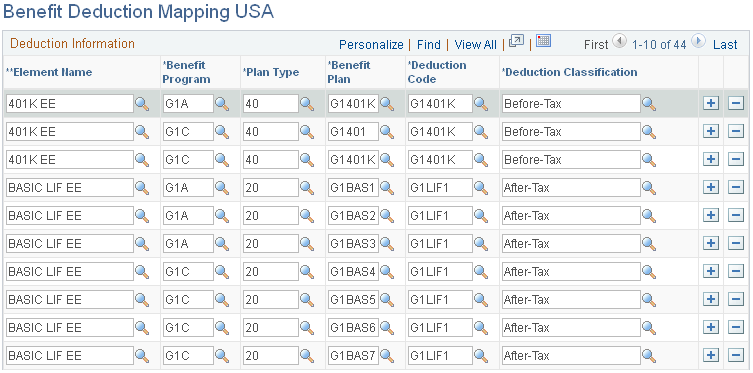

When you map a Global Payroll deduction element, you enter the element name, benefit program, plan type, and benefit plan. This combination of values is mapped to the Payroll for North America deduction code and deduction class. The element name, benefit program, plan type, and benefit plan combination can be mapped only once.
Use the Benefit Deduction Mapping USA page (GPUS_BENDED_MAP) to link deduction codes created in Payroll for North America to deduction elements created in PeopleSoft Global Payroll for United States.

Image: Benefit Deduction Mapping USA page
This example illustrates the fields and controls on the Benefit Deduction Mapping USA page.

| Element Name |
Select a benefit deduction element. Element names available for selection have a country code of USA, a PIN_TYPE of DD, and a PIN_CATEGORY of BEN. |
| Benefit Program |
Select a benefit program. Available benefit programs are pulled from the benefit programs defined by the PeopleSoft HR Manage Base Benefit business process. |
| Plan Type |
Select a plan type. Available plan types are pulled from the plan types defined by the Manage Base Benefit business process. |
| Benefit Plan |
Select a benefit plan. Available benefit plans are pulled from the benefit plans defined by the Manage Base Benefit business process. |
| Deduction Code |
Select a deduction code. Available deduction codes are pulled from the deduction codes defined by Payroll for North America. |
| Deduction Class |
Select a deduction class. |
Warning! After mapping the deduction elements to the deduction codes, do not delete any entries.
