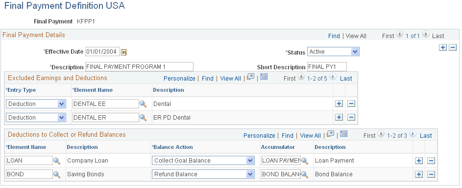

Use the Final Payment Definition USA page (GPUS_FPMT) to enter details about what elements to pay when a payee is terminated.
Image: Final Payment Definition USA page
This example illustrates the fields and controls on the Final Payment Definition USA page.
Excluded Earnings and Deductions
In this group box, indicate which earnings and deductions not to process.
Field or Control
Definition
Entry Type
Specify the type of element to exclude from the payroll process. Valid values are Earnings and Deduction.
Element Name
Enter the name of the element to exclude from the payroll process.
Note: If an element is listed in this group box and positive input exists, positive input takes priority.
Deductions to Collect or Refund Balances
In this group box, identify the deductions that have goal balances that you want to collect or refund.
Field or Control
Definition
Element Name
Enter the name of the deduction element with the balance to collect or refund.
Note: Any deduction can be entered, whether it has a goal balance or not. If a deduction is entered with no goal balance, then no special processing will occur for that element. If an element is entered and positive input exists, positive input takes priority.
Balance Action
Select the balance action. Valid values are:
  • Collect
    Select to collect the balance.
    For example, you can collect the unpaid portion of a loan deduction.
  • Refund
    Select to refund the balance.
    For example, you can refund the amount in an employee's Stock Purchase Plan (ESPP) account.
Accumulator
Specify the accumulator that holds the balance to collect or refund.
