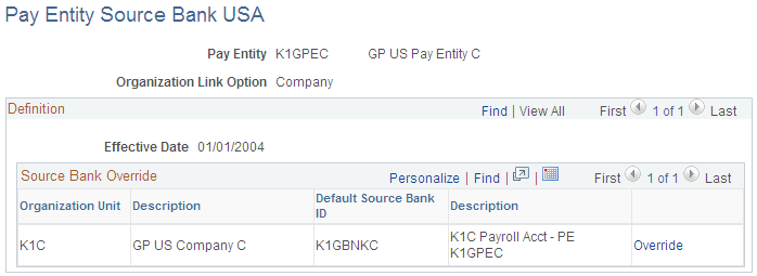

Use the Pay Entity Source Bank USA page (GPUS_PE_SBANK_OVRD) to select the pay entity for which you will override the source bank.
Image: Pay Entity Source Bank USA page
This example illustrates the fields and controls on the Pay Entity Source Bank USA page.
Field or Control
Definition
Organization Unit
Displays the organization unit that you defined on the Pay Entity - Source Bank Link page.
See Understanding Banking.
Field or Control
Definition
Default Source Bank ID
Displays the source bank ID that you defined on the Pay Entity - Source Bank Link page. If your organization has multiple source banks, you can override the default source bank on the Source Bank Override USA page.
Override
Select the Override link to access the Source Bank Override USA page.

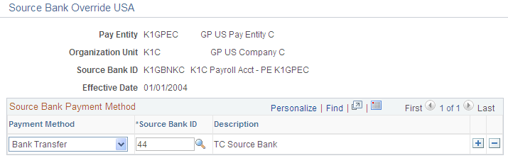

Use the Source Bank Override USA page (GPUS_PE_SBANK_SEC) to define the payment method and ID for the source bank override, if necessary.
Image: Source Bank Override USA page
This example illustrates the fields and controls on the Source Bank Override USA page.
The override option is used when multiple source banks are used.
Field or Control
Definition
Payment Method
Select the payment method to be used with the additional source bank. Options are Bank Transfer, Cash, Check, Postal Order, and Wire Transfer.
Note: You cannot have two rows with the same payment method.
Source Bank ID
Select the ID for the additional source bank.
