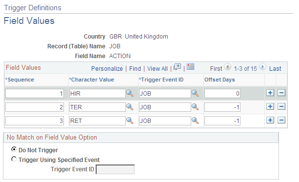

For the retro trigger for terminations and retirement actions, the OffSet Days field on the Trigger Definitions - Field Value page is set to –1 to adjust the effective date of the trigger compared to the effective date of the change in the JOB record. In earlier versions of Global Payroll, the trigger effective date was always equal to the effective date of the JOB record change.
This page shows the Offset Days setting for the UK retro trigger for JOB (select Set Up HCM, Product Related, Global Payroll and Absence Mgmt, Triggers, Trigger Definitions, Trigger Definitions. Click the List Field Values link on the Trigger Definitions page):
Image: Trigger Definitions - Field Values page for UK Retro Trigger
This example illustrates the fields and controls on the Trigger Definitions - Field Values page for UK Retro Trigger.
