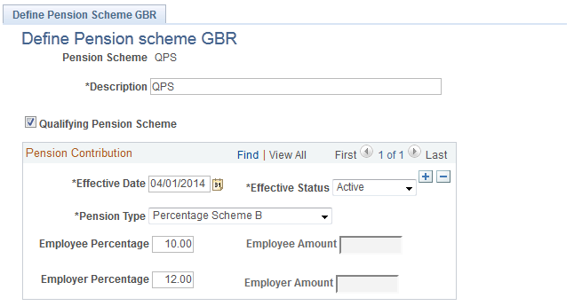

Use the Define Pension Scheme GBR page (GPGB_DEFPEN_SCHME) to define a pension scheme and the corresponding contribution details.
Image: Define Pension Scheme GBR page
This example illustrates the fields and controls on the Define Pension Scheme GBR page.
The contribution details entered in the Pension Contribution grid is used to update payee data for the pension during the auto enrolment process.
Field or Control
Definition
Pension Scheme
Enter a pension scheme to identify it as either Qualifying Pension Scheme (QPS) or Non-Qualifying Pension Scheme (NQPS).
Description
Enter a description about the pension scheme.
Select the check box to indicate that the pension scheme is a QPS.
Pension Type
Select one of the following pension types to define the format for contribution:
  • AVC1 – This type allows you to enter the percentage and amount value.
  • Fixed Scheme A – This type allows you to enter the amount value.
  • Percentage Scheme B – This type allows you to enter the percentage value.
Effective Date
Enter the date from which the pension scheme is effective.
Effective Status
Select the status of the pension scheme.
Employee Percentage
Enter the percentage of employee contribution for the pension.
Employer Percentage
Enter the percentage of employer contribution for the pension.
Employee Amount
Enter the amount of employee contribution for the pension.
Employer Amount
Enter the amount of employer contribution for the pension.

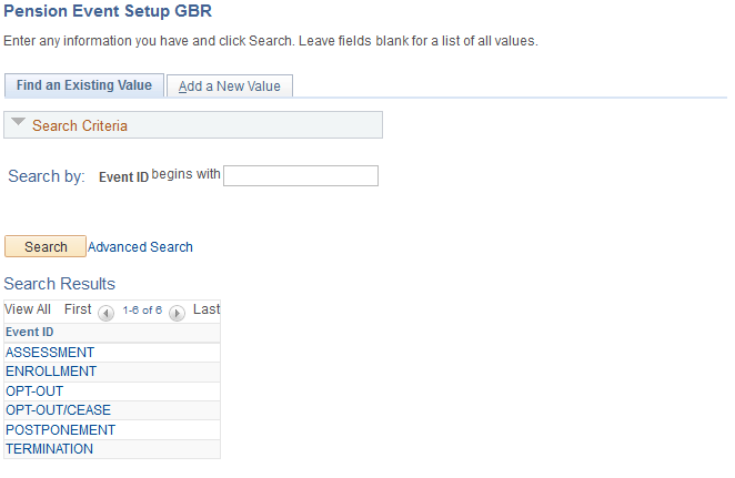

Use the Pension Event Setup GBR page (GPGB_SET_EVNT) to maintain events and the corresponding status for a pension applicant.
Image: Pension Event Setup GBR search page
This example illustrates the fields and controls on the Pension Event Setup GBR search page.
Pension Event Setup GBR search page displaying system default events

Whenever the auto enrolment process is run, the process updates the event and status corresponding to the process run date in the events table. The setup for the updates is defined in the Pension Event Setup GBR page.
The following table lists setup data available by default in the system. You can define your own events, statuses, and description but you need to ensure that the statuses are added to the automatic enrolment process.
