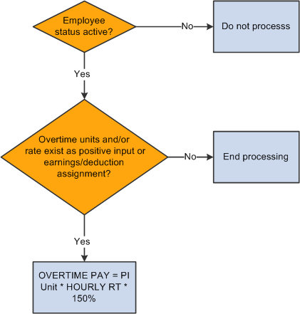

Overtime Pay
Global Payroll for China delivers the OVERTIME PAY earning as an example of how to calculate overtime pay for your payees.
  • The system calculates OVERTIME PAY using positive input units * HOURLY RT * 150%.
  • No proration is required because the assumption is that OVERTIME PAY will be entered through positive input.
This diagram illustrates the process flow for the OVERTIME PAY earning:
Image: Process flow for OVERTIME PAY earning
This diagram illustrates the process flow for the OVERTIME PAY earning.

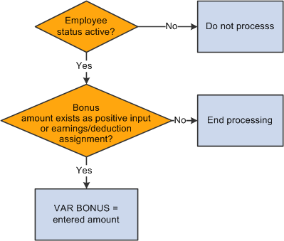

Variable Bonus
Global Payroll for China delivers the VAR BONUS earning as an example of how to enter variable bonus pay for your payees.
  • VAR BONUS is a fixed amount earning entered through positive input.
  • No proration is associated with VAR BONUS.
This diagram illustrates the process flow for the VAR BONUS earning:
Image: Process flow for VAR BONUS earning
This diagram illustrates the process flow for the VAR BONUS earning.

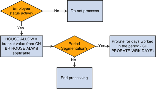

House Allowance
Global Payroll for China delivers the HOUSE ALLOW earning as an example of how to calculate a house allowance for your payees.
  • The system calculates the HOUSE ALLOW earning based on the CN BR HOUSE ALW bracket, which associates house allowances with annual rates of pay.
  • The system prorates HOUSE ALLOW for calendar periods using GP PRORATE WRK DAY.
    Note: Proration and rounding rules are set at the pay group level.
This diagram illustrates the process flow for the HOUSE ALLOW earning:
Image: Process flow for HOUSE ALLOW earning
This diagram illustrates the process flow for the HOUSE ALLOW earning.

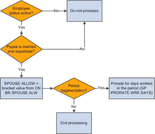

Spouse Allowance
Global Payroll for China delivers the SPOUSE ALLOW earning as an example of how to calculate a spouse allowance for your payees.
  • The generation control CN GC SPOUSE CHK determines whether payees are eligible for the SPOUSE ALLOW earning based on their marital status and employee type. Only married expatriate payees receive the SPOUSE ALLOW earning.
  • The system calculates the SPOUSE ALLOW earning based on the CN BR SPOUSE ALW bracket, which associates spouse allowances with employee type and annual rate of pay.
  • The system prorates SPOUSE ALLOW for calendar periods using GP PRORATE WRK DAY.
This diagram illustrates the process flow for the SPOUSE ALLOW earning:
Image: Process flow for SPOUSE ALLOW earning
This diagram illustrates the process flow for the SPOUSE ALLOW earning.
