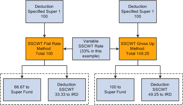

Superannuation deductions can have the SSCWT amount calculated by the flat rate method or the gross up method. For either method the rate can be the normal amount rate or the alternative rate. The employee can elect to have either calculation method use the higher rate.
For example, for an employer contribution of 100 at the normal rate of 33 percent:
  • The flat rate calculation results in 66.67 to super fund, 33.33 to IRD.
  • The gross-up calculation results in 100 to super fund, 49.25 to IRD (grossed-up amount = 149.25).
Image: The two methods of calculating SSCWT produce different deductions amounts and different super fund amounts.
The following diagram illustrates this example and shows how the deduction amounts and super fund amounts are different for the two different calculations methods:
