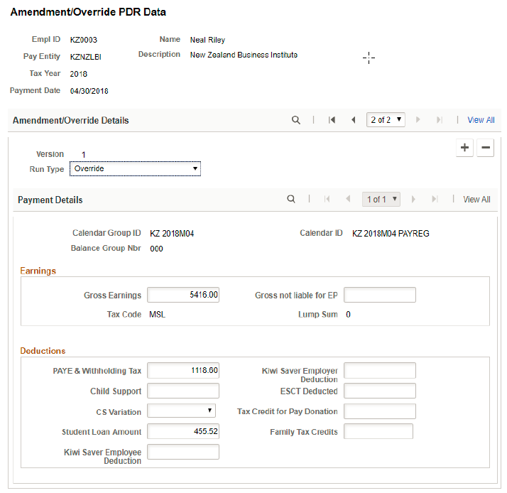

Override
Use Override option if you had run Payday reporting file in the production mode and needs to correct earnings and deduction values for some employees before submitting the file in myIR. This is not to add delta value; it is to enter the expected value, which is required to report in the file. The new values will override the existing earnings and deductions details.
Note: Override can only be performed for a finalized calendar. In case of multiple calendars in a payment date then all calendars that corresponds to a payment date should be finalized.
Image: Amendment/Override PDR page when Override is selected as the Run Type
This example illustrates the Amendment/Override PDR page when Override is selected as the Run Type.
Amendment Override PDR page_Override
Edit the earnings and deductions fields corresponding to each Payment date or Calendar Group and save the record. Adjusted values are considered only for Payday Reporting and the same will not cascade to payroll results automatically.
Once the changes are saved, create file from Create PDR Employment File page by selecting ‘Original’ in the report type. File will be generated with the new values.
