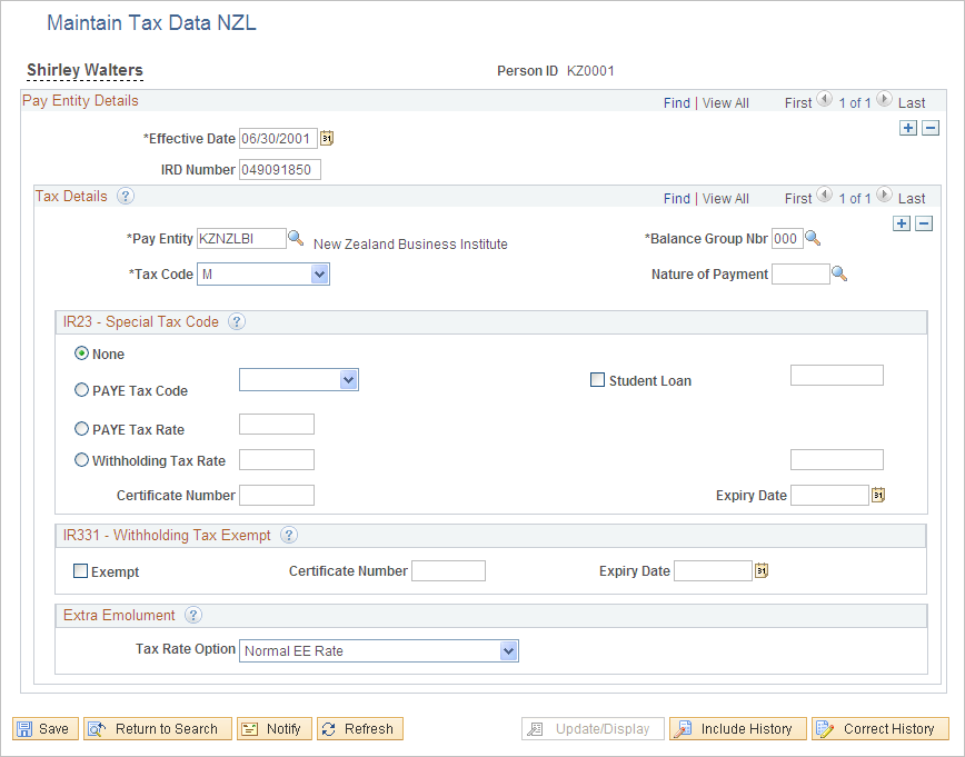

Use the Maintain Tax Data NZL page (GPNZ_EE_TAX_DETAIL) to enter tax information as supplied by the payee.
Image: Maintain Tax Data NZL page
This example illustrates the fields and controls on the Maintain Tax Data NZL page. You can find definitions for the fields and controls later on this page.
Payee tax details are keyed by pay entity and balance group number, allowing payees with concurrent jobs to have different tax details for each job. This page, on which you enter payee tax information, is designed to be similar to the IRD forms — IR 330, 23 and 331 — that the payee supplies.
