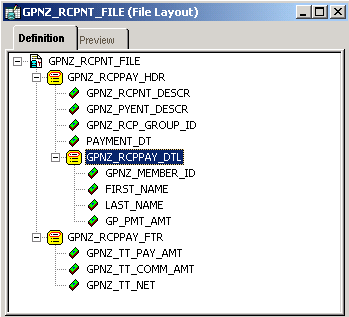

It is common for organizations to transmit a file to a recipient so they can update their records. For example, an organization may pay a recipient weekly and at the end of the month deliver a file with all the payment details. Recipients generally specify the information they want and the report file layout. After you have created the file layout, link it to the recipient in the Deduction Recipients NZL page in
The process creates a separate flat file for each recipient/group ID/Pay Entity/Pay Date combination. The files are named xxxxxx99.TXT where xxxxxx is the recipient ID and 99 is a sequence number.
We have supplied a sample file layout, GPNZ_RCPNT_FILE. Application Engine program GPNZ_RCPFILE gets the file layout which is stored on the Deduction Recipients NZL page.
Note: The Application Engine program GPNZ_RCPFILE is written to process only the GPNZ_RCPNT_FILE recipient schedule file. You can make minor changes to that file, for example field order, but if you make major file layout changes you will need to create additional Application Engine programs to process them.
Image: Sample recipient file layout
This example illustrates a sample recipient file layout.
Note: This electronic file depends on the prior running of Application Engine program GPNZ_EFT_MT9 for recipients.

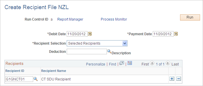

Use the Create Recipient File NZL page (GPNZ_RUNCTL_RCP_FL) to enter the parameters for generating recipient payment files.
Navigation
Image: Create Recipient File NZL page
This example illustrates the fields and controls on the Create Recipient File NZL page. You can find definitions for the fields and controls later on this page.
Field or Control |
Definition |
| Debit Date |
The system extracts recipient payments where the debit date is equal to the recipient's deposit schedule. If the recipient does not have a deposit schedule the system exacts payments using the debit date without reference to a deposit schedule. |
| Payment Date |
This is the date, passed to the file header, that the bank passed the payment to the recipient. It is written to the output report file. |
| Recipient Selection |
Select from All Recipients, Selected Deduction, or Selected Recipients. You select only one deduction but multiple recipients for the second and third options. |
