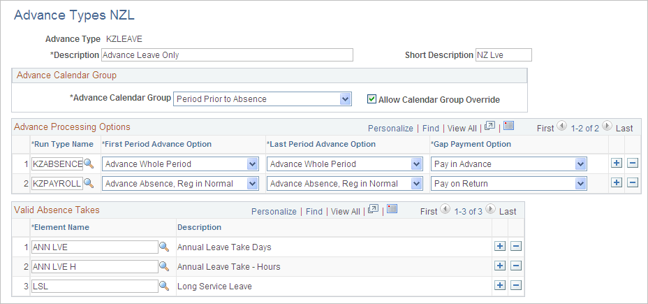

Use the Advance Types NZL page (GPNZ_ADV_TYPES) to define the first and last period advance processing options and link absence takes to the advance type.
Image: Advance Types NZL page
This example illustrates the fields and controls on the Advance Types NZL page. You can find definitions for the fields and controls later on this page.
These are the key points about advance types:
  • You define which periods should be advanced for an absence.
  • You specify which absence takes the advance type can be used with.
  • A single advance type can be used with multiple absence takes.
  • Multiple advance types can use the same absence takes.
  • When you specify the absence take on an absence event entry, you can only select advance types that the take has been associated with.
Advance Calendar Group
Field or Control
Definition
Use the options here to determine the calendar group in which to pay the advance. Select from:
Payment After Absence Begin: The advance is paid in the calendar group that contains the first payment date after the absence begins.
Payment Prior to Absence Begin: The advance is paid in the calendar group that contains the last payment date prior to the absence begin date.
Period Absence Begins: The advance is paid in the calendar group that contains the period in which the absence begins.
Period Prior to Absence: The advance is paid in the calendar group that contains the period immediately prior to the one in which absence begin date falls.
Allow Calendar Group Override
Select this check box if you want to be able to override the calendar group that the system selected. The system calculates the calendar group using the options above, but you can override it on the Pay In Advance NZL page.
Advance Processing Options
Field or Control
Definition
Run Type Name
Select a run type.
You need to set up the advance processing options for each run type because absence run types generally need to be treated differently from payroll runs. For the system to calculate absences correctly, they must be run in the correct sequence. The system does not calculate absences correctly if the previous period's entitlements have not already been accrued. For this reason, for absence run types, the system sets the default value of the First Period and Last Period fields to Advance Whole Period, and the default value of the Gap field to Advance, regardless of the options set for the payroll run types.
Warning! It is important to advance the whole period for absence calendars to ensure that the accruals/entitlement calculations are correct and accumulators are updated in chronological order. If an absence begins and/or ends in mid-period and the absence is advanced with the First Period and Last Period (see below) set to Advance Absence, Reg in Normal or Advance Absence, Reg on Return , the system calculates accruals/entitlement only for the absence days in that period and updates leave accumulators only for those days. This could result in the employee having insufficient leave balance to cover the absence. In addition, this setup could cause the regular days accruals/entitlement to be calculated in the normal calendar or the return calendar, instead of the calendar where the advance payment occurs. And if an anniversary occurs during the partial period or gap being advanced, the leave accumulator results could be incorrect.
Note: An exception exists if an absence entitlement accrual is based on actual hours worked. This situation reverses the normal "absence then payroll" run sequence to "payroll then absence." In this situation you need to define a separate process list with the "hours per hour" entitlement in a section in that process list. You then need to create a separate run type for this process list and that run type needs to have the same First Period and Last Period options as the payroll run type.
First Period and Last Period Advance Option
These options determine what should happen for the period in which the absence begins. Select from the following valid values:
  • Advance Absence, Reg in Normal (Regular in Normal): Only the part of the period while on absences is advanced. The rest of the period is paid in its normal calendar group.
  • Advance Absence, Reg on Return (Regular on Return): Only the part of the period while on absences is advanced. The rest of the period is paid after the absence.
    Note: This is not an option for last period.
  • Advance Whole Period: The entire period is paid in advance.
  • No Advance: The period is not being advanced at all. It is paid at the normal time.
Gap Payment Option
A gap is a pay period that is prior to the absence, but where the payment date falls during the absence. Select from the following valid values:
  • Advance: The gap is paid in advance.
  • Normal: The gap is paid at the normal time.
  • On Return: The gap is included in the first payment made after the payee returns from the absence.
Valid Absence Takes
Field or Control
Definition
Element Name
Enter the absence take with which this advance type can be used.

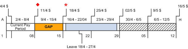

Gap Payment Option Examples
The following two diagrams show the On Return and Normal Cycle gap options in effect. For both scenarios, the First Period and Last Period options are both Advance Whole Period. The diamond marks the advanced leave payment date and the asterisk marks the gap pay date.
Image: Gap on return
In this diagram, the gap is paid on return. Therefore, the payment occurs on the first payment date after the return from leave.
Gap on return
Payment Schedule
16/4 - 17/4 Regular
Pay Period Ending 08/4 (so paid 11/4)
18/4 - 27/4 Leave
28/4 - 29/4 Regular
09/4 - 15/4 Gap
Pay Period Ending 15/04 (so paid 02/5)

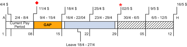

Image: Gap in normal cycle
In this diagram, the gap is paid in the normal cycle. Therefore, the payment occurs on the regular payment date for the gap period, even though the employee is on leave.
Gap in normal cycle
Payment Schedule
16/4 - 17/4 Regular
18/4 - 27/4 Leave
28/4 - 29/4 Regular
09/4 - 15/4 Gap
Pay Period Ending 29/04 (so paid 18/4)

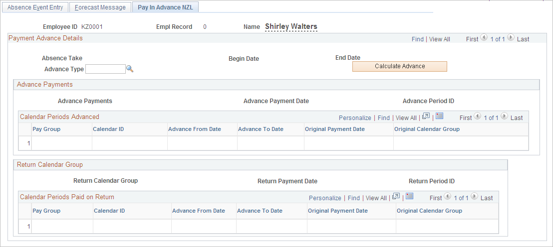

Use the Pay In Advance NZL page (GPNZ_ABS_EVENT_ADV) to .
Image: Pay In Advance NZL page
This example illustrates the fields and controls on the Pay In Advance NZL page. You can find definitions for the fields and controls later on this page.
This page displays details of how and when the advance will be paid according to the Advance Type you enter.
Enter the advance typethat you want this absence event to use. When you click the Calculate Advance button, the system displays information about how and when the advance payment is made based on the advance type's rules.
The system displays the information in two group boxes, Advance Payments and Return Calendar Group.
Advance Payments
Field or Control
Definition
Advance Payments (advance calendar group)
This is the calendar group the system has determined the advance payment will be made.
Advance Payment Date
This is the payment date of the regular pay calendar in the calendar group.
Advance Period ID
These are the from and to dates of the regular pay calendar in the calendar group.
Calendar Periods Advanced
Field or Control
Definition
Pay Group
This is the pay group in the calendar the pay would be paid in if not advanced.
Calendar ID
This is the calendar the pay would be paid in if not advanced.
Advance From Date
From date of the period being advanced.
Advance To Date
To date of the period being advanced.
Original Payment Date
This is the payment date for the calendar the pay would be paid in if not advanced.
Original Calendar Group
This is the calendar group the pay would be paid in if not advanced.
