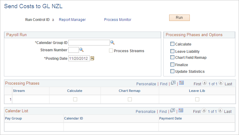

Use the Send Costs to GL NZL page (GPNZ_GL_PREPARE) to initiate the processes for calculation of GL data, leave liability, and finalization of the GLI and statistical data updating.
Image: Send Costs to GL NZL page
This example illustrates the fields and controls on the Send Costs to GL NZL page. You can find definitions for the fields and controls later on this page.
Note: The differences between this page and the page you access through Compensate Employees, Manage Payroll Process, Process (GP_GL_PREPARE) is the additional processing phase option of Leave Liability and Chart Field Remap.
Processing Phases and Options
Field or Control
Definition
Chart Field Remap
Select this check box to enable the ChartField remap application program when running the General Ledger process. This run control page enables you to run an Application Engine process (GPNZL_GL_MAP) that updates ChartFields in GP_GL_DATA. The program selects and updates the necessary GP_GL_DATA records with specified ChartField overrides. When you run the GL interface finalize process, the data is summarized using your chosen (remapped) ChartFields for correct account mapping.
