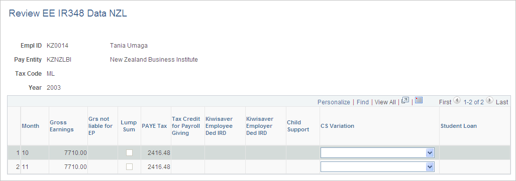

On the Review EE IR348 Data NZL page (navigation Global Payroll & Absence Mgmt > Authority Correspondence > Review EE IR348 Data NZL > Review EE IR348 Data NZL), you can view employee level IR 348 data and adjust the Child Support Variation code if required.

Use the Review EE IR348 Data NZL page (GPNZ_INQ_IR_EMPLEE) to view employee level IR 348 data and adjust the Child Support Variation code if required.
Image: Review EE IR348 Data NZL page
This example illustrates the fields and controls on the Review EE IR348 Data NZL page. You can find definitions for the fields and controls later on this page.
All the data on this page comes from the NZ IRD Details record.
Field or Control
Definition
Lump Sum
The system selects this check box if there is a value in EXTRA EMLMNT FMTDA (Extra Emolument - WA Reporting) accumulator for the month.
CS Variation (child support variation)
You can manually override the variation code if there is a value in the Child Support field. If there is no value in that field, the system displays 0 in the CS Variation field.
  • A: Advance pay.
  • C: Ceased employment.
  • D: Deducted previously.
  • P: Protected earnings.
  • S: Short-term absence.
  • O: Other. This is the default value if there is no value in the Child Support field.
If the normal amount of the Child Support deduction is not the same as the amount in the month-to-date accumulator, the system determines why, using the IRD specified order of priority, and sets the CS variation code according to the conditions:
  • If the payee is terminated (that is, has a finish date): code C.
  • If there is a value in the CS Advance month-to-date accumulator: code A.
  • If there is a value in the CS Not Taken month-to-date accumulator: code P.
  • If the C, A or P codes are not appropriate: O.
