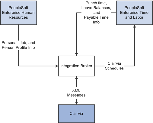

PeopleSoft HCM integrates with Clairvia through the PeopleSoft Integration Broker (IB), which is a messaging system that enables you to synchronize data from one application or system with another. PeopleSoft Integration Broker facilitates synchronous and asynchronous messaging among internal systems and trading partners, while managing message structure, message format, and transport disparities.
Image: Information flow between PeopleSoft HCM, Time and Labor, and Clairvia
The following diagram illustrates the flow of information between PeopleSoft HCM applications and Clairvia:
When PeopleSoft HCM products and Clairvia are integrated, the following information is exchanged asynchronously between the applications:
  • PeopleSoft Human Resources sends employee personal, job, and person profile information to Clairvia.
  • PeopleSoft Time and Labor sends employee reported punch time, leave balances, and payable time to Clairvia.
  • Clairvia sends employee work schedule and scheduled leave information back to Time and Labor.
