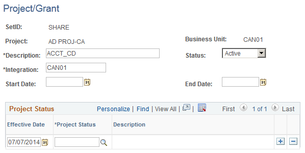

Use the Project/Grant page (PROJECT_CF) to add project values, set up project start and end dates, and project status.
This page is not available for entry if you are integrating with PeopleSoft Financials.
Navigation
Click the Project/Grant link on the ChartField Values page.
Image: Project/Grant page
This example illustrates the fields and controls on the Project/Grant page. You can find definitions for the fields and controls later on this page.
Field or Control |
Definition |
| Integration |
Use to select an integration template for the project and project level. |
| Start Date and End Date |
These fields are for information only. There is no processing behind them. |
| Project Status |
Enter the effective date and select a project status to indicate the various stages of the life cycle for the project. Note: These fields are for information only. |

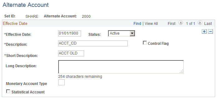

Use the Alternate Account page (ALTACCOUNT) to set up new alternate account ChartField values.
Navigation
Click the Alternate Account link on the ChartField Values page.
Image: Alternate Account page
This example illustrates the fields and controls on the Alternate Account page. You can find definitions for the fields and controls later on this page.
The PeopleSoft alternate account feature enables you to enter a statutory chart of accounts as well as analytic or primary accounts at the detail transaction level. The alternate account produces journal line or transaction level balances for statutory reporting requirements. The primary account ChartField contains the corporate accounts, and alternate account ChartField contains the statutory accounts. This is useful for organizations that have two different reporting requirements—one for internal management or a corporate parent, and another for a local jurisdiction or national government.
In PeopleSoft applications, the analytic or primary account ChartField is ACCOUNT.
Local regulatory authorities often require statutory accounts. In PeopleSoft applications, this is termed the alternate account ChartField (ALTACCT).
You link alternate account ChartField values with account ChartField values. When you enter values for the account ChartField, the system enters the associated alternate account value. When you enter values for the alternate account ChartField, the system enters the associated account value. You can override the default values by selecting another value from the prompt list. The system displays only account values that you have mapped to the account or alternate account ChartField.
Note: You can map alternate account ChartFields only to account ChartFields with the same attributes unless they have a different Set ID.
Field or Control |
Definition |
| Long Description |
Optionally, you can enter the purpose or use of the alternate account, and an explanation of the type of transactions that are to be posted to it. Note: This field is for information only. |
| Monetary Account Type |
Select from the types previously defined on the Account Types page. Note: This field is for information only. |
| Statistical Account |
Used for statistical amounts, not monetary amounts. If you select the check box, you must specify a unit of measure. Note: This field is for information only. |
| Control Flag |
Select to indicate that you can update this alternate account only by using the Journal Generator. A control account represents a summarization of detail from an application. Note: This field is for information only. |
