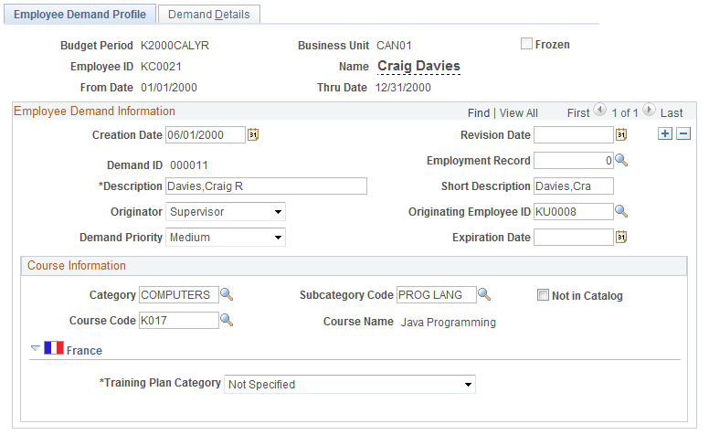

Use the Employee Demand - Employee Demand Profile page (TRN_DEMAND_EE_1) to enter the courses that the selected employee requires during the budget period set up on the Budget Period page.
Enter audit information for the demand.
Image: Employee Demand - Employee Demand Profile page
This example illustrates the fields and controls on the Employee Demand - Employee Demand Profile page. You can find definitions for the fields and controls later on this page.
Specify the course that this training demand applies to. When you first enter this page, the course information values are UNKNOWN.
To enter additional courses that this employee needs to take during the specified budget period, place the cursor in the Category field and insert new rows.
Course Information
Field or Control
Definition
Category, Subcategory Code Course Code
If you aren't sure which course this demand is for, select the category and subcategory codes and leave the course code blank.
Note: You cannot select a subcategory until you've selected a category.
Not in Catalog
Select if the training course isn't defined in the Catalog table.

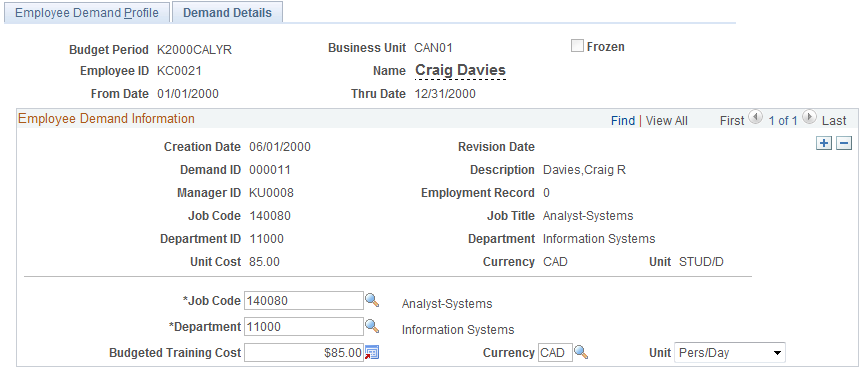

Use the Employee Demand - Demand Details page (TRN_DEMAND_EE_2) to enter additional employee demand details, including job code, department, and training costs.

Job Code, Department, and Budgeted Training Cost
The system populates these fields from the employee's job data. For budget purposes, you can select a job code, department, or employee training budgeted cost if it is different from the values that are currently defined for this employee. You might do this if the employee details will be different in the future period. For example, the employee may be transferring to another department and job with a different employee training budgeted cost.
For employee training budgeted cost, indicate the currency that the cost is tracked in.
You specify the default currency for business units for a budget period on the Budget Period table. Budgets are automatically converted to the default base currency that you establish on the Training Base Currency table (TRN_BASE_CURRENCY).
Unit
Select the cost unit for the value in the Empl. Training Budgeted Cost field. This is the cost to train the employee with respect to the employee's wages. Values are:
Select the cost unit for the cost that you entered in the Per Unit Cost fields. The Compute Student Cost process uses the Cost Unit field to divide the cost against the students' training session. Values are:
Flat Cost: The cost is a fixed rate, it is not dependent on the course session duration.
Pers/Day: The cost is based on what the employee earns in a day.
Pers/Hour: The cost is the employee's hourly wage.
Pers/Month: The cost is the employee's monthly wage.
Pers/Train: The cost unit may be useful to enter a cost that is not converted by the computation process. The Paid Hours field is non applicable and disabled when this cost unit is selected.
Pers/Week: The cost is the employee's weekly wage.
Pers/Year: The cost is the employee's yearly wage.

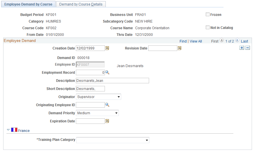

Use the Employee Demand by Course page (TRN_DEMAND_EECRS_1) to define the employees who require the selected training course and enter audit information for the demand.
Image: Employee Demand by Course page
This example illustrates the fields and controls on the Employee Demand by Course page. You can find definitions for the fields and controls later on this page.
Field or Control
Definition
Not in Catalog
Selected by default if the training course hasn't been defined in the Catalog table.
Employee ID
Insert a row for each employee who needs to attend the course. Employees can come from any department that is associated with the specified business unit.
