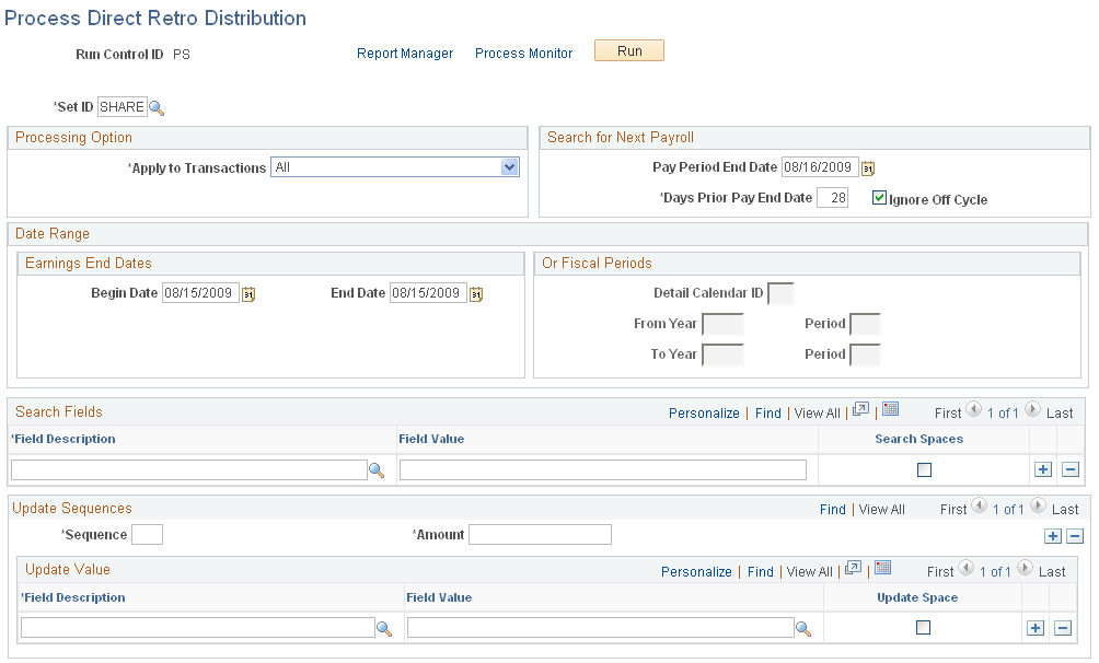

You can redistribute funding sources directly in the actuals records at the department, job code, position pool, position, or job data (appointment) level without making changes to the department budget. The Direct Retro Distributions (direct retroactive distributions) process selects the records that fit your search criteria. It updates the data in specified fields with the new data from the run control page.
Note: The system only selects records processed by the Commitment Accounting GL Interface process.
In this section we discuss how to:
Specify search criteria, and indicate which fields to update and the data to update them with.
Run the Retro Distribution process.
View the earning, deduction, or tax-related messages generated by the Retro Distribution process.
Use the Process Direct Retro Distribution (process direct retroactive distribution) page (RUN_HP_RETDISTSRCH) to do the following.
Enter search criteria to specify which records to modify.
Indicate which field values the system should update and with what values.
Run the Retro Distribution (retroactive distribution) process.
Navigation
Image: Process Direct Retro Distribution page
This example illustrates the fields and controls on the Process Direct Retro Distribution page.
The Direct Retro Distributions process does not apply any changes to the database. If this process produces warnings or errors (viewed in the Review Retro Distributions Msgs components) you can rerun this process with different parameters.
Processing Option
Field or Control |
Definition |
| Apply to Transactions |
Search for Next Payroll
Field or Control |
Definition |
| Pay Period End Date |
The pay period end date defaults the end date closest to, but not included in, the last CA GL Interface process run. Enter a new pay period end date, if necessary. The system only processes pay periods that have not been processed by the CA GL Interface. |
| Days Prior End Date |
Enter the number of days prior to the posting date of the pay calendar. |
| Ignore Off Cycle |
Select to ignore off cycle pay calendars. |
Transaction Date Range
The process searches for the earnings end dates that fall within the date range you specify.
Field or Control |
Definition |
| Begin Date and End Date |
Enter the transaction begin and end dates. Clear these fields to use fiscal periods as the date range. |
Or Fiscal Periods
Field or Control |
Definition |
| Detail Calendar ID |
Select a detail calendar ID. |
| From Year/Period and To Year/Period |
Enter the year and period from and to which you want to process. |
Search Fields
Field or Control |
Definition |
| Field Description and Field Value |
Select the fields and the field values of the records you want the process to search for. |
| Search Spaces |
Select to have the system search for blank field values. |
Update Sequences
Field or Control |
Definition |
| Sequence (sequence number) |
Enter the sequence in which this funding amount should be used. |
| Amount |
Enter the funding amount. |
Update Value
Field or Control |
Definition |
| Field Description and Field Values |
Select the fields in the selected records that should be updated and the values they should be updated with. |
| Update Space |
Select to have the system update spaces. |
