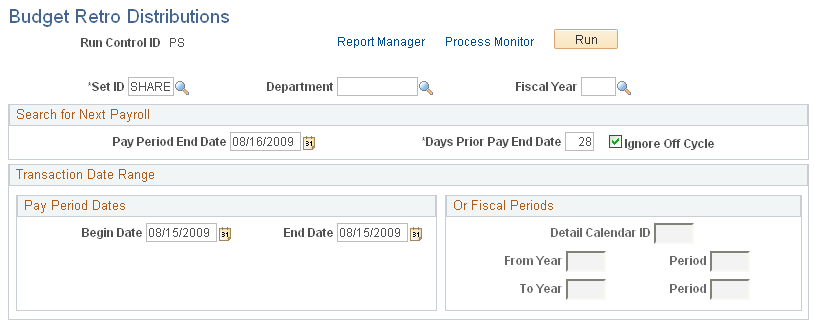

Use the Budget Retro Distributions (budget retroactive distributions) page (RUN_HP_RETDISTBDGT) to redistribute effected paycheck transactions using the new department budget setup.
Navigation
Image: Budget Retro Distributions page
This example illustrates the fields and controls on the Budget Retro Distributions page.
Field or Control |
Definition |
| SetID, Department, and Fiscal Year |
Enter the department budget's setID, department, and fiscal year. |
Search for Next Payroll
Field or Control |
Definition |
| Pay Period End Date |
Enter the end date of the pay period that you are processing retroactive distributions for. This must be the same pay ending date as the original entry. |
| Days Prior End Date |
Enter the number of days prior to the posting date of the pay calendar. |
| Ignore Off Cycle |
Select to ignore off cycle pay calendars. |
Transaction Date Range
The process searches for the earnings end dates that fall within the specified date range.
Pay Period Dates
Field or Control |
Definition |
| Begin Date and End Date |
Enter the transaction begin and end dates. Clear these fields to use fiscal periods as the date range. |
Or Fiscal Periods
Field or Control |
Definition |
| Detail Calendar ID |
Select a detail calendar ID |
| From Year/Period and To Year/Period |
Enter the year and period from and to which you want to process. |
Note: The Budget Retro Distribution does not update transactions for which the Combination Code has been overridden.
