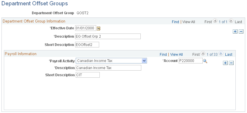

Use the Department Offset Groups page (DEPT_OFFSET_GRP) to establish offset groups to use as part of your department budgets.
Navigation
Image: Department Offset Groups page
This example illustrates the fields and controls on the Department Offset Groups page.
Field or Control |
Definition |
| Payroll Activity |
Select a valid payroll activity. You can associate more than one activity with a Department Offset Group.Add a new row to add more activities. |
| Account |
Enter a valid account code. The code you select is the funding source for all plan types in the selected Payroll Activity, unless otherwise specified. |
Plan Information
This group box appears when you select a Payroll Activity of Deduction.
Field or Control |
Definition |
| Plan Type |
Select a deduction plan type. You can associate more than one plan type with a payroll activity. Add a new row to add more plan types. |
| Deduction Code |
Select a deduction code. The list of available options depends on the Plan Type you specified. |
| Deduction Classification |
Select a deduction class, such as Before Tax or After-Tax |
| Account |
Select a deduction plan type account to be used instead of the account specified for the Payroll Activity. |
