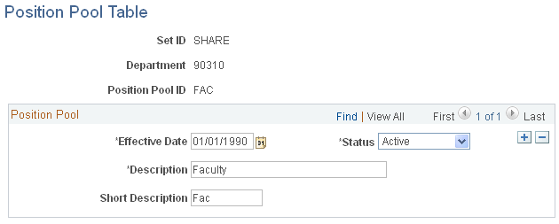

Use the Position Pool Table page (POOL_TBL) to set up position pool IDs.
Image: Position Pool Table page
This example illustrates the fields and controls on the Position Pool Table page.

Position Pool ID
Identifies a position pool. Assign positions to a position pool on the Position Data component (POSITION_DATA) and then set up budgets for position pools using the Commitment Accounting business process.
