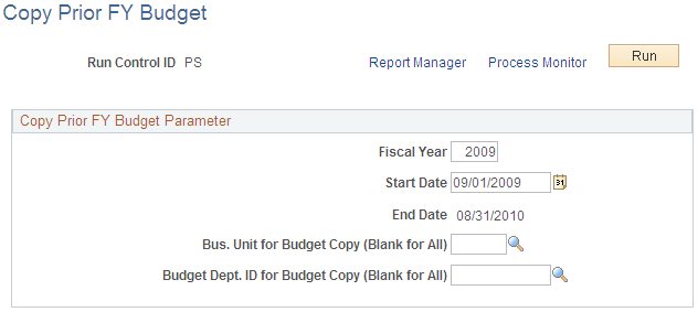

Use the Copy Prior FY Budget (copy prior fiscal year budget) page (RUNCTL_BUD006) to generate a new annual budget using last year's budget information.
Navigation
Image: Copy Prior FY Budget page
This example illustrates the fields and controls on the Copy Prior FY Budget page.
 Field or Control  |
 Definition  |
| Fiscal Year |
 Enter the fiscal year of the budget you are creating.  |
| Start Date and End Date |
 Enter the fiscal year's beginning date. The system then calculates the End Date by adding 365 days to the Start Date you enter. (If February 29th falls within your budget year, modify the Structured Query Report [SQR] program file to set the Dayinyear variable to 366.)  |
| Bus. Unit for Budget Copy (Blank for All) |
 If applicable, enter the business unit budget you want to copy. Leave this field blank if you want to copy budgets for all business units.  |
| Budget Dept. ID for Budget Copy (Blank for All) |
 If applicable, enter the department ID for the budget you want to copy. Leave this field blank if you want to copy budgets for all departments.  |
| Run |
 Select to run this request.  |
