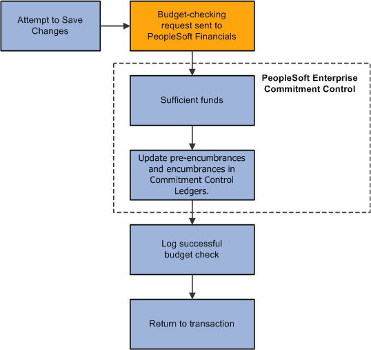

Immediate Budget Checking: Sufficient Funds
When your settings result in immediate budget checking, the system immediately recalculates encumbrances when a user attempts to save a job data change or position data change that affects the encumbrance amount. The system then sends the encumbrance data to the Commitment Control Budget Processor in PeopleSoft Financials, which in turn verifies that there are sufficient funds available for the recalculated encumbrance amounts.
If there are sufficient funds, the PeopleSoft Financials system updates the Commitment Control ledger encumbrance amounts immediately, as shown in this process flow:
Image: Budget check shows that there are sufficient funds
This diagram illustrates that if there are sufficient funds, the PeopleSoft Financials system updates the Commitment Control ledger encumbrance amounts immediately.
The specific encumbrance and pre-encumbrance calculations depend on the changes that are made. Note, however, that when you fill a position, the system liquidates the pre-encumbrance as well as creating an encumbrance for the new job record.

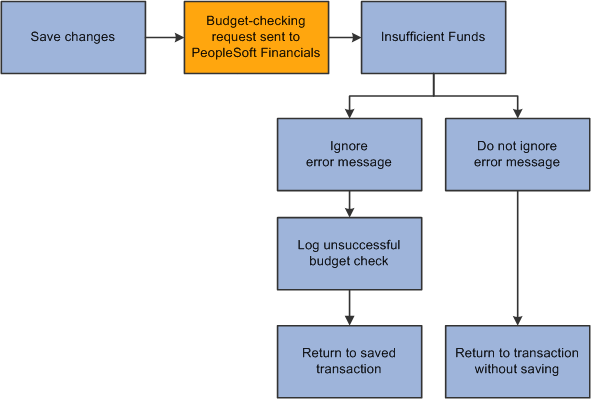

Immediate Budget Checking: Insufficient Funds
If the system initiates immediate budget checking and there are insufficient funds, the Financials system provides an error message to assist the user in addressing the budget error. The user's options depend on whether the transaction is critical and, if so, whether you enforce real-time budget checking for critical transactions. Enforcing real-time budget checking means that not only does the system immediately check for funds, the system won't let you save critical changes unless sufficient funds are available. You configure this option on the Installation Table - Product Specific page.
If the transaction is critical, and the system is configured to enforce budget-checking for critical transactions, the user cannot save the transaction without resolving the error condition. The following diagram illustrates enforced immediate real-time budget checking:
Image: Enforced compliance with real-time budget checking
This diagram illustrates enforced immediate real-time budget checking:
If the transaction is not critical, or if it is critical but the system does not enforce budget compliance for critical changes, then when the budget check shows that there are insufficient funds, the user can choose whether to address the error message or ignore it and save anyway.
When the user does not ignore the budget check error, the system does not save the original transaction and the user can either cancel the changes or modify the changes and attempt another budget check.
The following diagram illustrates the results of ignoring and not ignoring the insufficient funds notification from PeopleSoft Financials:
Image: User chooses whether to ignore insufficient funds
This diagram illustrates the results of ignoring and not ignoring the insufficient funds notification from PeopleSoft Financials

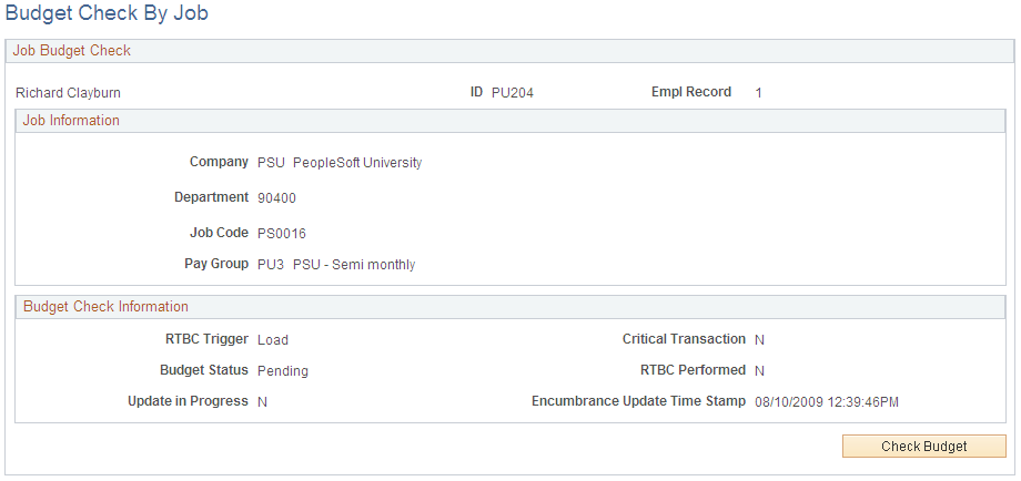

Use the Budget Check By Job page (HP_BDCK_JOB) to perform budget checking for position data.
Image: Budget Check By Job page
This example illustrates the fields and controls on the Budget Check By Job page.
Budget Check by Job page
Review the transaction data, and select the Check Budget button to initiate the budget check.
Budget Check Information
Field or Control
Definition
RTBC Trigger (real-time budget checking trigger)
Displays the source component of the budget check transaction.
Critical Transaction
Displays Y (yes) if the last job data change was a critical transaction, or N (no) if it change was not critical.
Budget Status
Displays the current budget check status for the job: Valid or Invalid.
RTBC Performed
Displays Y (yes) if a real-time budget check has been performed, or N (no) if not.
Update in Progress
Displays Y (yes) if there is another real-time budget check transaction taking place for this job, or N (no) if not.
Encumbrance Update Time Stamp
Displays the date and time of the last encumbrance transaction.

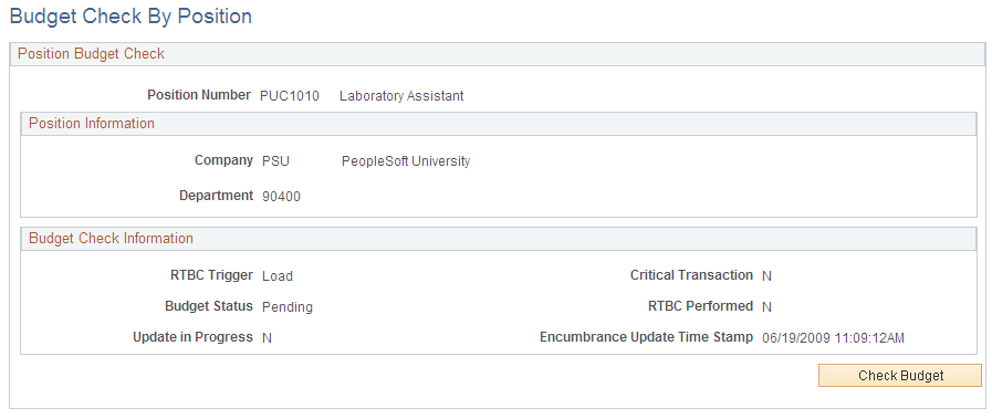

Use the Budget Check by Position page (HP_BDCK_POS) to perform budget checking for position data.
Image: Budget Check by Position page
This example illustrates the fields and controls on the Budget Check by Position page.
Field or Control
Definition
Displays Y (yes) if the last position data change was a critical transaction, or N (no) if it change was not critical.
Budget Status
Displays the current budget check status for the position: Valid or Invalid.
RTBC Performed
Update in Progress
Displays Y (yes) if there is another real-time budget check transaction taking place for this position, or N (no) if not.
