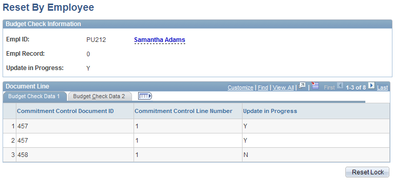

Use the Reset by Employee page (HP_RESET_LOCK_JOB) to review locks placed by real-time budget checking for job data changes, and reset the locks if necessary.
Image: Reset By Employee page: Budget Check Data 1 tab
This example illustrates the fields and controls on the Reset By Employee page: Budget Check Data 1 tab.
Image: Reset By Employee page: Budget Check Data 2 tab
This example illustrates the fields and controls on the Reset By Employee page: Budget Check Data 2 tab.

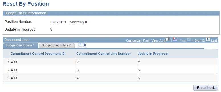

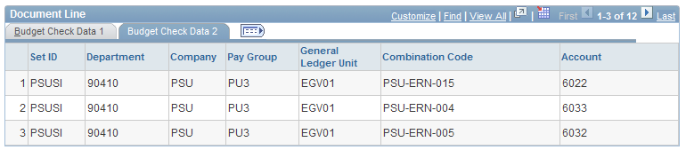

Use the Reset by Position page (HP_RESET_LOCK_POS) to review locks placed by real-time budget checking for position data changes, and reset the locks if necessary.
Image: Reset By Position page: Budget Check Data 1 tab
This example illustrates the fields and controls on the Reset By Position page: Budget Check Data 1 tab.
Image: Reset By Position page: Budget Check Data 2 tab
This example illustrates the fields and controls on the Reset By Position page: Budget Check Data 2 tab.

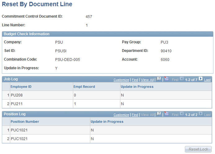

Use the Reset By Document Line page (HP_RESET_LOCK_DOC) to review locks placed by real-time budget checking and reset the locks if necessary.
Image: Reset By Document Line page
This example illustrates the fields and controls on the Reset By Document Line page.

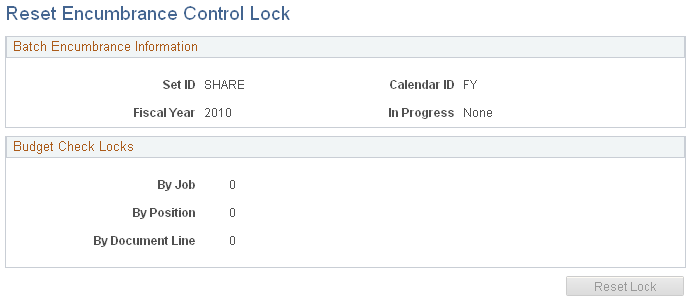

Use the Reset Encumbrance Control Lock page (HP_RESET_LOCK_BCH) to review locks placed by the Batch Encumbrance Calculation Process, and reset the locks if necessary.
Image: Reset Encumbrance Control Lock page
This example illustrates the fields and controls on the Reset Encumbrance Control Lock page.
