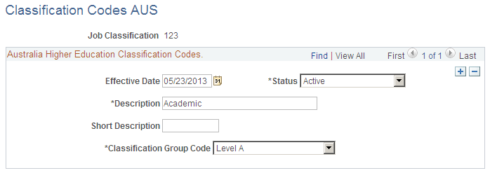

Use the Classification Codes AUS page (DETYA_CLSN_AUS) to define classification codes specific to DETYA reporting.
Image: Classification Codes AUS page
This example illustrates the fields and controls on the Classification Codes AUS page.
Field or Control
Definition
Classification Group Code
Select the appropriate classification group corresponding to the code being defined. The group code defines the level of work being performed. DETYA defines these groups and the corresponding codes. Options are Abv Sr Lec (above senior lecturer), Level A, Level B, Level C and Non Acad (non academic).

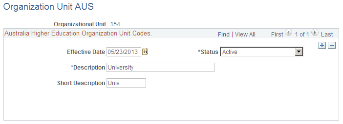

Use the Organization Unit AUS page (DETYA_ORGUNIT_AUS) to define organizational units specific to DETYA reporting.
Image: Organization Unit AUS page
This example illustrates the fields and controls on the Organization Unit AUS page.
Field or Control
Definition
Effective Date, Description and Short Description
Define the information for each organizational unit.
