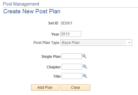

Use the Post Management – Create New Post Plan page, Post Management – Modify Post Plan page, or Post Management – View Plan Details page (GPS_VT_NEW) to enter basic information for a new post plan, or search information to find and update existing post plans.
Image: Post Management – Create New Post Plan page
This example illustrates the fields and controls on the Post Management – Create New Post Plan page.
Post Management - Create New Post Plan page
To create a post plan, enter information for all fields on this page. It will be used as of the basic, header information of the new post plan.
To modify or view an existing plan, use these fields as search fields and enter search criteria for the system to return matching post plans.
Additional search fields are available on this page for modifying post plans and viewing post plan details:
  • Post Type
  • Row Status
  • Grade
  • Rank

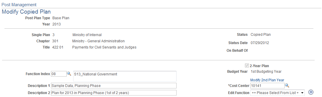

Use the Post Management – Modify Copied Plan page (GPS_POSTPLN_NEW) to add or modify post plan details.
Image: Post Management – Modify Copied Plan page (1 of 2)
This example illustrates the fields and controls on the Post Management – Modify Copied Plan page (1 of 2).
Post Management - Modify Copied Plan page (1 of 2)
Image: Post Management – Modify Copied Plan page (2 of 2)
This example illustrates the fields and controls on the Post Management – Modify Copied Plan page (2 of 2).
Post Management - Modify Copied Plan page (2 of 2)
This page is used to create as well as modify post plans. When you modify a plan that was copied over from the previous fiscal year, some of the page fields are read-only.
Based on the budgeting system that is selected in the installation level, the number of fields (used for identify the budgeting entity) and field labels in the header area can vary. For example, if Kameralistik is used, Single Plan, Chapter and Title field labels are displayed as delivered. If Doppik is the selected budgeting system, Product Area, Product Group, Product, and Account field labels are displayed.
Note: For users who are not part of the planning or administration group and therefore don’t necessarily have the right access post plans, they can view post plans from the Post Management – View Plan page. Post plans are displayed in the read-only mode. Approved plans and closed plans, which are not modifiable anymore, are displayed using the same page.

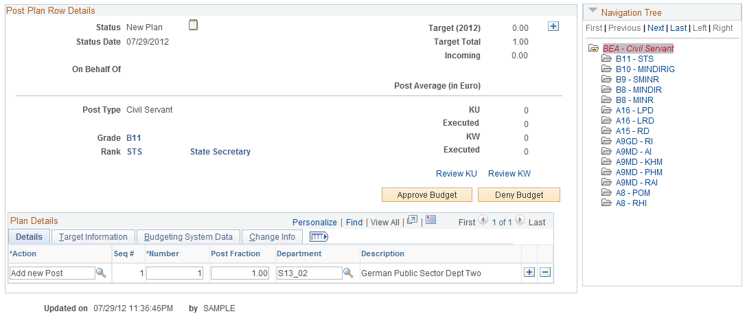

Post Plan Row Details
A post plan row shows the number of posts, specified by grade and rank, to be assigned to any given agency within the public sector. For example, a planner may add one chief inspector (grade) post, one inspector (grade) post and 10 sergeant (grade) posts for the police department of a city government. Each row must be approved via the federal budget in order for the plan to be eligible for approval.
Use this section to perform planning activities, such as add post plan rows (or delete them if created in error), modify post plan row details, and taking necessary actions on posts based on requirements.

Plan Details
Use this section to add individual posts to the post plan row, or perform other action on posts that are in the target of the post plan row (to be executed during cleanup). Actions are defined on the Post Management – Setup Action Table page.
For new plans, the only available action is Add new Post.
For copied plans, additional actions are available based on action status and availability.
Depending on the selected action, some fields become editable for the planner to enter relevant information needed for the action. For example, if the Decrement or Increment action is selected, the planner needs to specify the grade and rank (in addition to number of post and post fraction) that the post or posts should be changed to after the action is performed.
During the planning phase, the edit functions (available in the Action field) are used as instructions to the administrator, listing the actions that need to be performed by administrators on posts during the cleanup phase. Used during planning, they impact the calculation of the target total for the row plan. A plan cannot be activated unless all edit functions that were set during the planning phase are executed.
Field or Control
Definition
Number
Enter the number of posts on which the corresponding action will need to be executed during the cleanup phase. For example, if the action selected is to add new post and the number is set to 2, two new posts will be added during the cleanup phase.
Post Fraction
Enter the assignment fraction. For example, add 2 new posts with a post fraction of 0.5. A fraction number cannot exceed the value of 1.
Approve Budget
Click to approve the current post plan row.
Clicking this button transfers the user to the Approval Authorization page (GPS_INBEHALF2_SEC) where an approver is specified.
After an approver is selected, the system changes the status of the current row to Approved, and its button label to Reset Approval. Clicking the Reset Approval button sets the status back to the original status and the date to the date prior to the change. Reset is available only until the approval is saved.
Deny Budget
Click to deny the current post plan row. Clicking this button changes the status or the current row to Denied, and its button label to Reset Denial.
Navigation Tree
The tree provides a visual representation of the post plan structure and it displays all post plan rows pertaining to the plan. It allows administrators to navigate from one post plan row to the next easily. Each post plan row is shown as a node with its grade and rank as the node name. Clicking a node link refreshes the Post Plan Row Details section with information for that node.

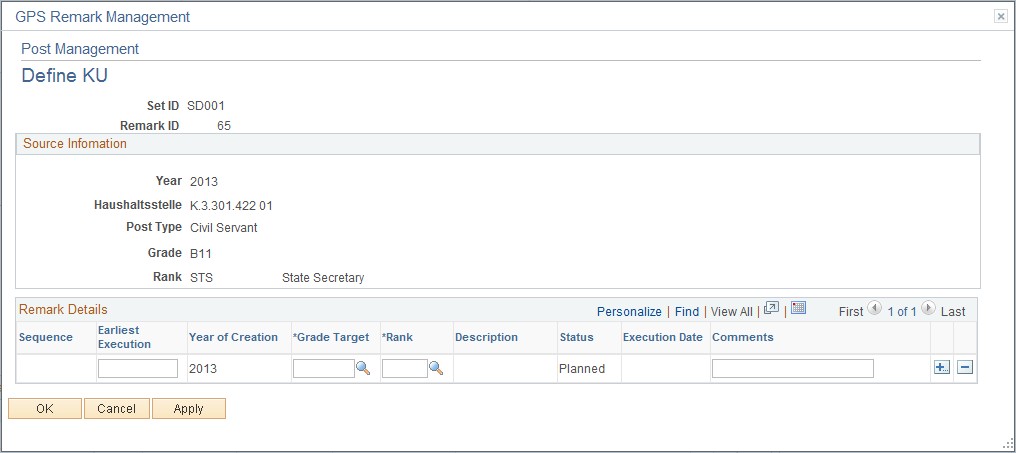

Use the Post Management – Define KU page or Post Management – Define KW page (GPS_REMARK_EDIT) to define KU or KW remarks for the corresponding post plan row.
Image: Post Management – Define KU page
This example illustrates the fields and controls on the Post Management – Define KU page.
Post Management - Define KU page
The same page is used for defining KUs and KWs. Available fields are slight different depending on which type of remark (KU or KW) you are entering.
A KW (kuenfig wegfallend) indicates that a post would be discontinued and removed as soon as it becomes vacant, where a KU (kuenftig umzuwandeln) remark indicates that a post needs to be changed to the grade and rank specified in the definition as soon as it becomes vacant.

Remark Details
Use this section to enter one or more remarks for the corresponding post plan row (information is listed in the Source Information section).
Field or Control
Definition
Earliest Execution
The year entered here must be equal to or greater than the current year.
Grade Target
This field applies to KUs only.
Rank
This field is required for civil service posts and applies to KUs only.
