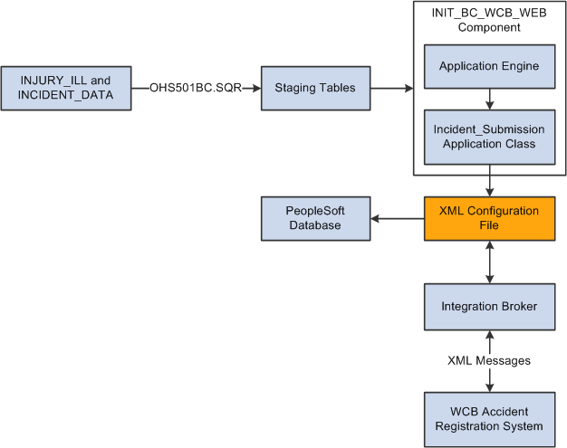

Submitting Injury Reports
This diagram illustrates the process flow for submitting injury reports using the WorkSafeBC web service:
Image: Injury report submittal process
Process flow for submitting injury reports using WorkSafeBC web service.
  1. You initiate the OHS501BC.SQR process to collect injury and incident data from the INJURY_ILL and INCIDENT_DATA tables and use it to populate staging tables. The process collects the following types of data:
    • Incident/injury data.
    • Corrective preventative actions.
    • Non-employee information.
    • Employee information.
    • Employment information.
    • Claims information.
  2. Using the INIT_BC_WCB_WEB component, you trigger the Incident_Submission application class, which collects data from the staging tables and uses it to generate an XML file. The same application class also initiates a web service operation through Integration Broker to send the XML file as a SOAP envelope to the WCB's Accident Registration System.
  3. After receiving the XML file, the WCB system validates it and returns either completion codes confirming that the validation was successful, or error codes indicating that the validation failed.
  4. Based on the response from WCB, the PeopleSoft system parses the XML file and extracts the data to update the database.

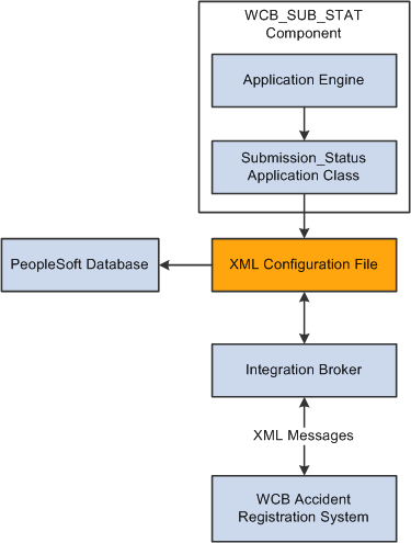

Requesting Submission Statuses
This diagram illustrates the process flow for requesting submission statuses using the WorkSafeBC web service:
Image: Submission status request process
Process flow for requesting submission statuses using WorkSafeBC web service.
  1. Using the WCB_SUB_STAT component, you initiate the Submission_Status application class.
  2. The application class generates an XML file and initiates a web service operation through Integration Broker to send the XML file as a SOAP envelope to WCB's Accident Registration System.

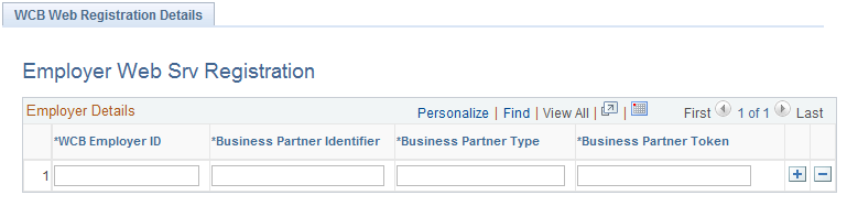

Use the Employer Web Srv Registration page (WCB_WEB_REG_DTLS) to enter employer WCB registration details.
Image: Employer Web Srv Registration page
This example illustrates the fields and controls on the Employer Web Srv Registration page. You can find definitions for the fields and controls later on this page.
Field or Control
Definition
WCB Employer ID
Enter the employer ID assigned by the WCB.
Business Partner Identifier
Enter the six-digit WCB account number.
Business Partner Type
Enter the role type assigned to the employer during web service registration.
Business Partner Token
Enter the unique credential issued to each business partner.

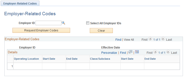

Use the Employer-Related Codes page (WCB_EMPLR_REL_CD) to request employer codes.
Image: Employer-Related Codes page
This example illustrates the fields and controls on the Employer-Related Codes page. You can find definitions for the fields and controls later on this page.
Use this page to retrieve employer-related codes from the WCB. An employer should run this web service every time that it adds, changes or deletes operating locations or industry classifications because the WCB validates every web service transmission to ensure that the codes are correct.
Field or Control
Definition
Employer ID
Enter the ID of the employer for which you want to request employer-related codes.
Select All Employer IDs
Select to request codes for all valid employer IDs.
Request Employer Codes
Click to initiate the employer-related codes request to the WCB. The WCB sends a response message containing the valid employer-related code values for the selected employer ID.
Clear
Click to deselect the displayed information in the Employer Related Codes group box.
Operating Location
Displays the identification number of the employer's operating location(s) as assigned by the WCB. The Start Date andEnd Date fields next to this field represent the date on which the location became active and the date on which it became inactive, respectively.
Class/Subclass
Displays the type of industry classification assigned to the employer by the WCB. The Start Date andEnd Date fields next to this field represent the date on which the classification unit became active and the date on which it became inactive, respectively.

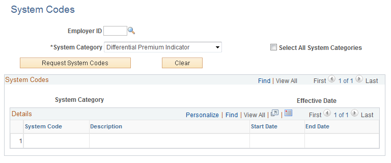

Use the System Codes page (WCB_SYSTEM_CD) to request system codes.
Image: System Codes page
This example illustrates the fields and controls on the System Codes page. You can find definitions for the fields and controls later on this page.
System Codes page
Use this page to request system codes. It is necessary to request system codes only once during implementation unless new system codes are added.
Field or Control
Definition
Employer ID
Select the ID of the employer for which you are requesting system codes.
System Category
Select the system category for which you are requesting codes.
Select All System Categories
Select to request system codes for all valid system categories.
Request System Codes
Click to initiate the system codes request to the WCB. The WCB sends a response message containing the valid system code values for the selected system category.
Clear
Click to deselect the displayed information in the System Code group box.
System Code
Displays the system codes of the system category that you select.
Description
Displays the description of the system code.
Start Date
Indicates the date on which the system code became active.
End Date
Indicates the date on which the system code became inactive.
Note: One of the system codes is SEXTY, which is the gender code. The PeopleSoft system derives the gender of an EmplID from the Personal Data table, so the gender values of Male and Female are hard coded. These values are the same as those currently delivered by the WCB, but if these values change or new values are added, you need to update the hard coded PeopleSoft values accordingly.

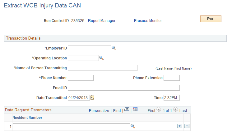

Use the Extract WCB Injury Data CAN page (RUNCTL_WCB_501) to run the OHS501BC SQR process to populate staging tables with WCB injury data.
Image: Extract WCB Injury Data CAN page
This example illustrates the fields and controls on the Extract WCB Injury Data CAN page. You can find definitions for the fields and controls later on this page.
(CAN) Use this page to run the OHS501BC SQR process, which extracts injury data to staging tables, where it can then be transmitted to the WCB.
Transaction Details
Field or Control
Definition
Employer ID
Operating Location
Enter your organization's operating location ID.
Name of Person Transmitting
Enter the name of the primary point of contact for the transmitting organization.
Phone Number
Enter the phone number of the primary point of contact for the transmitting organization.
Phone Extension
Enter the phone extension of the primary point of contact for the transmitting organization.
Email ID
Enter the email address of the primary point of contact for the transmitting organization.
Date Transmitted
Enter the date on which the injury report data was extracted.
Time
Enter the time at which the injury report data was extracted.
Data Request Parameters
Use this group box to select the incidents for which you want to extract injury data.
