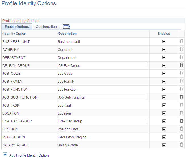

Image: Profile Identity Options page: Enable Options tab
This example illustrates the fields and controls on the Profile Identity Options page: Enable Options tab. You can find definitions for the fields and controls later on this page.

Enable Options Tab
Field or Control |
Definition |
| Enabled |
Select this check box to allow profile types to be linked to the entity specified in the Identity Option field. If this check box is deselected, you cannot set up a profile type with this entity. For example, if you deselect the check box for the Job_Sub_Function option, you cannot define a profile type using the Job_Sub_Function profile identity option. |

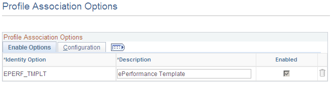

Image: Profile Association Options page: Enable Options tab
This example illustrates the fields and controls on the Profile Association Options page: Enable Options tab. You can find definitions for the fields and controls later on this page.

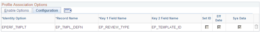

This example illustrates the fields and controls on the Profile Association Options page: Configuration tab. You can find definitions for the fields and controls later on this page.
Use this page to define the entities external to the Manage Profiles business process to which you can link profile types. ePerformance Template is a delivered profile association option. The addition of other associations would require customizations to leverage. Enter the identity option on the Enable Options tab. Enter the record name and key field information on the Configuration tab.
