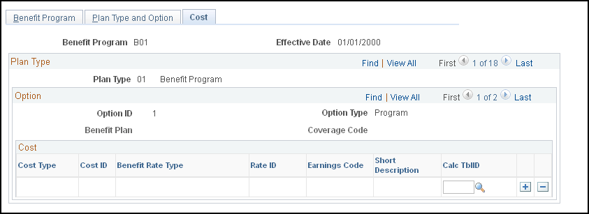

BEN_PROG_DEFN3 |
Link a benefit program and plan type to rate and calculate rules. |

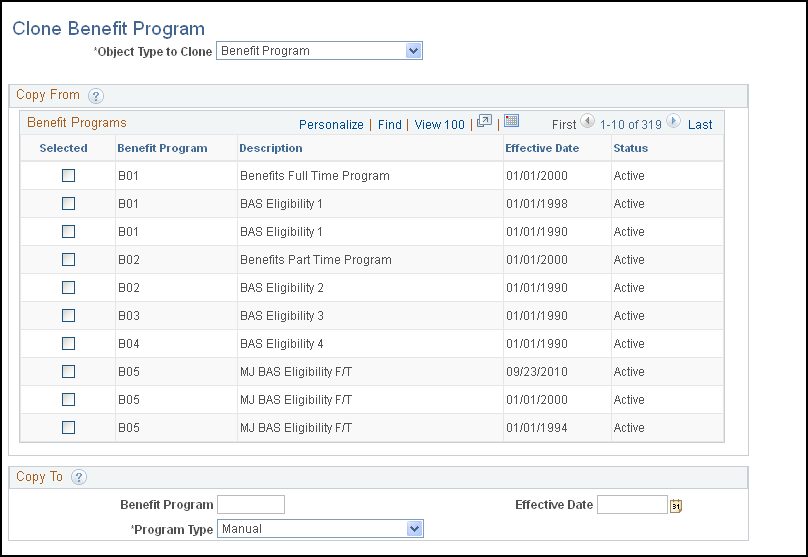

BN_CLONE |
Use the benefit program clone utility to identify a benefit program and have the system make an exact copy of that program with a different effective date. Give the duplicate program the same name as the original or rename it, which saves you time and effort when you create a new benefit program with a future effective date. |

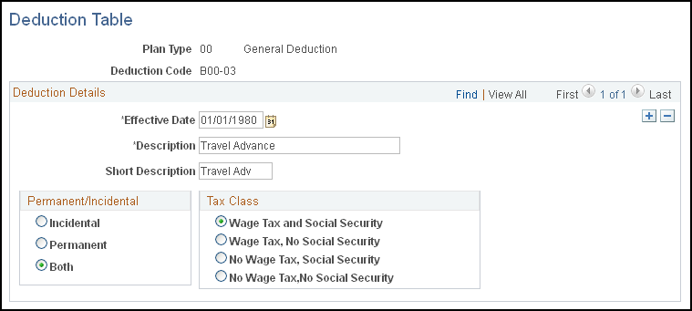

Use the Deduction Table page to specify, for all benefits deductions and general deductions, whether a deduction is permanent or incidental and how the deduction affects taxes.

Use the Deduction Table page (DEDUCT_TABLE1_NL) to specify, for all benefits deductions and general deductions, whether a deduction is permanent or incidental and how the deduction affects taxes.
Navigation
Image: Deduction Table page
This example illustrates the fields and controls on the Deduction Table page. You can find definitions for the fields and controls later on this page.
Note: Deductions on the Deduction table are grouped by plan type. The plan type code for general deductions is always 00. Benefit deduction plan type codes vary depending on the nature of the benefit, but are already coded into the system as translate values. If you want to create plan types, use Z0 through ZZ. You must also ensure that the deduction codes you create are the same ones that you used in the General Deduction Table and the Benefits Table.

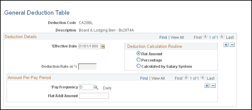

Use the General Deduction Table page (GENL_DEDUCT_TBL_NL) to set up general deduction data and define how nonbenefit deductions are calculated.
These deductions include parking fees, union dues, or garnishments. (For benefit deductions, use one of the Benefits tables.)
Navigation
Image: General Deduction Table page
This example illustrates the fields and controls on the General Deduction Table page. You can find definitions for the fields and controls later on this page.
Field or Control |
Definition |
| Deduction Calculation Routine |
For each general deduction, indicate the type of deduction calculation routine that your payroll system uses to determine the amount of the deduction. If you select a deduction calculation routine that uses a deduction rate or percent, also enter a flat/additional amount per pay period to be deducted. However, you must indicate the amount here only if it's the same for all employees within a pay frequency. Flat Amount: Select if the deduction is a flat amount. Enter the amount in the Deduction Flat/Addl Amount (deduction flat/additional amount) field. Percentage: Select if the deduction is calculated as a percentage. Enter the percentage in the Deduction Rate or % (deduction rate or percent) field. Calculated by Salary System: Select if the deduction is calculated by the payroll system. |
Amount Per Pay Period
This group box displays the amount to be deducted from an employee's pay every pay period.
Field or Control |
Definition |
| Pay Frequency |
If you have a deduction that varies by pay frequency, indicate the amount deducted in each pay period for each pay frequency. For example, if there is a 50.00 EUR per month parking deduction for the company GBI, set up the deduction for the semimonthly pay group KN2 so that it applies only to the last pay period of the month. Rather than taking out 25.00 EUR each pay period, take the full 50.00 EUR at the end of the month. To set this up, indicate both the frequency and amount. |
| Deduction Flat/Addl Amount (deduction flat /additional amount) |
If you select a deduction calculation routine that uses a flat amount, enter a flat amount or additional deduction amount. However, indicate the amount here only if it's the same for all employees within a pay frequency. |

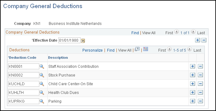

Use the Company General Deductions page (GDED_COM_TBL) to set up general deductions for your organization.
Navigation
Image: Company General Deductions page
This example illustrates the fields and controls on the Company General Deductions page. You can find definitions for the fields and controls later on this page.
Field or Control |
Definition |
| Deduction Code |
Select deduction codes that are applicable for your company. Deduction codes are created on the Deduction Table page (DEDUCT_TABLE1_NL). |

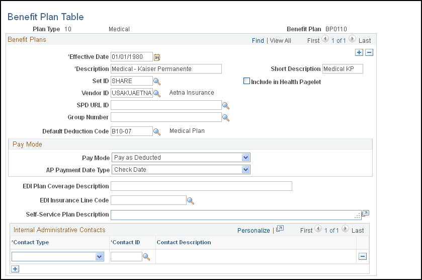

Use the Benefit Plan Table page (BENEFIT_PLAN_TABLE ) to set up a benefit plan definition.
Also define providers, provider codes, and default deduction codes for all plan types.
Navigation
Image: Benefit Plan Table page
This example illustrates the fields and controls on the Benefit Plan Table page. You can find definitions for the fields and controls later on this page.
Field or Control |
Definition |
| Vendor ID |
Select the provider of the benefit plan. Use the Provider/Vendor Table component to set up providers. |
| Group Number |
Select the group number. Define group numbers on the Provider/Vendor Table — Policy Information page. |
| SPD URL ID (summary plan description uniform resource locator identification) |
PeopleSoft eBenefits provides access to the summary plan description on the Provider Policy Table. Select the URL ID to the location of the summary plan description. |
| Default Deduction Code |
(Optional) Enter a default code here to save you from typing the deduction code each time that you associate this benefit plan with a benefit program on the Benefit/Deduction Program Table. (Deduction codes are created on the Deduction Table page.) |
| Pay Mode |
Fields in this group box are for use with PeopleSoft Payroll for North America only. |
| EDI Plan Coverage Description |
This field appears for health plans and is for use in North America only. |
| EDI Insurance Line Code |
| Self-Service Plan Description |
Use only for health (1x), disability (3x), leave (5x), and retirement (7x) plans. Enter text describing the benefit plan that will also appear on eBenefits pages. |

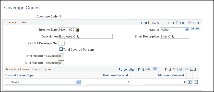

Use the Coverage Codes page (COVRG_CD_TBL) to create new coverage codes for your benefit programs.
We recommend that you give the coverage code a numerical values of one through seven. Coverage codes should be ordered according to their complexity, with Employee being first.
Navigation
Image: Coverage Codes page
This example illustrates the fields and controls on the Coverage Codes page. You can find definitions for the fields and controls later on this page.
Field or Control |
Definition |
| COBRA Coverage Set |
This field is not used by organizations in the Netherlands. |
| Total Covered Persons |
Select this check box to activate the total covered person types functionality for this coverage code. |
| Total Minimum Covered and Total Maximum Covered |
These fields are only visible when the Total Covered Persons check box is selected. Enter the allowable minimum and maximum covered persons. Include the employee in this count. |
Allowable Covered Person Types
Field or Control |
Definition |
| Covered Person Type |
Select the type of person for which you are setting parameters. Note: The coverage code controls for covered person type are used in PeopleSoft Benefits Administration. |
| Minimum Number Covered |
Enter the minimum number of covered persons allowed. If you have selected the Total Covered Persons check box, this field is not editable. |
| Maximum Number Covered |
Enter the maximum number of covered person allowed. If there is no limit to the number for this coverage code, enter 99. If you have selected the Total Covered Persons check box, this field is not editable. |

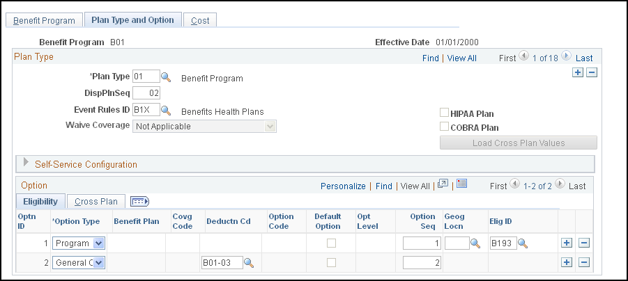

Use the Plan Type and Option page (BEN_PROG_DEFN2) to link plan types to the benefit program and add important information about plan types.
Navigation
Image: Plan Type and Option page
This example illustrates the fields and controls on the Plan Type and Option page. You can find definitions for the fields and controls later on this page.
Plan Type
Field or Control |
Definition |
| Plan Type |
Select a plan type from the predefined list of values. By adding rows, you can use this page to enter information for each plan type associated with a particular benefit program. Plan Type 01 also called the program level of the benefit program, is used only by benefit programs that run in association with Benefits Administration. |
| Waive Coverage |
Select this check box if the plan type allows it. |
Important! The DispPlnSeq, Event Rules ID, COBRA Plan, HIPAA Plan, and Load Cross Plan Values elements are for Canadian and U.S. functionality and are not for operations in the Netherlands.
Self-Service Configuration
The fields in this group box are for Canadian and U.S. functionality and are not for operations in the Netherlands.
Option
Field or Control |
Definition |
| Optn ID (option ID) |
As you define options for each of the offered plan types, the system automatically enters the option ID. |
| Optn Type (option type) |
Each row must have an option type designation. The option type that you select determines the remaining fields that you must complete on the Plan Type and Option (BEN_PROG_DEFN2) and the Cost (BEN_PROG_DEFN3) pages Gen Deduction (general deduction): Allowed only for plan type 00, which you use for general deductions. Option: At least one O is required for each plan type except 01. Gen Credit (general credit): Used only in benefit programs that run in association with Benefits Administration. Program: Used only in benefit programs that run in association with Benefits Administration. Waive Optn (waive option): Used only in benefit programs that run in association with Benefits Administration. |
| Benefit Plan |
Enter the code for a benefit plan that was defined on the Benefit Plan Table page. |
| Covrg Code (coverage code) |
Indicate the level of coverage for health plan types (1x). This is a required field for those plan types. |
| Deductn Cd (deduction code) |
Indicate how to handle deductions. |
Important! The Option Seq (option sequence), Option Code, Opt Level (option level), Geog Locn (geographic location), and Elig ID (eligibility rules ID), fields are all used for Benefits Administration and are not for operations in the Netherlands.
Use the Cost page (BEN_PROG_DEFN3) to link a benefit program and plan type to rate and calculate rules.
Navigation
Image: Cost page
This example illustrates the fields and controls on the Cost page. You can find definitions for the fields and controls later on this page.
Field or Control |
Definition |
| Cost Type |
Select a cost type: Price, or Credit. |
| Benefit Rate Type |
Select a rate type to specify which table should be used to determine rates for the plan type. |
Important! The Rate ID, Earn Code (earnings code), Cost ID, and Calc TblID (calculate table ID) fields are all used for Benefits Administration and are not for operations in the Netherlands.
Use the Clone Benefit Program page (BN_CLONE) to use the benefit program clone utility to identify a benefit program and have the system make an exact copy of that program with a different effective date.
Navigation
Image: Clone Benefit Program page
This example illustrates the fields and controls on the Clone Benefit Program page. You can find definitions for the fields and controls later on this page.
Field or Control |
Definition |
| Object Type to Clone |
Select the type of object you want to copy: Benefit Program, Coverage Formula, Eligibility Rule, or Event Rule. |
| Selected |
Select the check box for the benefit program, coverage formula, eligibility rule, or event rule that you can to copy. |
Copy To
This group box defines the name of the new object that will be created. These fields vary, depending upon the type of object you're cloning.
