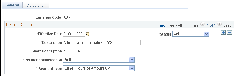

| Permanent/Incidental |
Select whether the earnings code is Permanent, Incidental, or Both. |
| Payment Type |
Select the payment type. Values are: Amts Only (amounts only): Select if you want to enable the entry of amounts for earnings. Both: Some companies need the ability to enter both hours and an amount for earnings. Select this option to record an employee's hours (for your records only) and to enter the actual amount of pay that you want the employee to receive. Either: Select if you want to enable the entry of either hours or amount, but not both, for earnings. Flat Amt (flat amount): Select to define an earnings code as a flat amount and also specify the amount. For example, you want to give multiple employees a specific flat amount of additional pay. You can maintain this type of flat amount and make mass changes to the flat amount on the Earnings table, instead of changing multiple additional pay records at the employee level. Hours Only: Select if you want to enable the entry of hours for earnings. Sal System (salary system): Select if a third-party payroll system defines the way to process the payment for earnings. Units/Ovr (units/override): Select and specify a rate if you want to set up your payroll system to override the hourly rate on the employee's job record, or if you want to provide an earnings code for piecework earnings. |

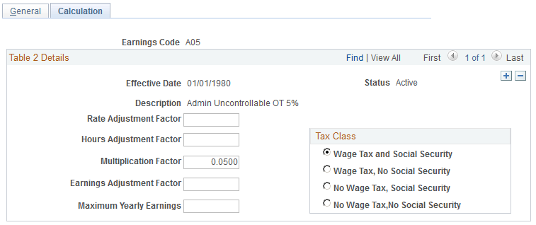

| Rate Adjustment Factor |
The amount that applies to adjustments in pay rates. For example, if your collective labor agreement included an hourly cost of living adjustment, enter the value in this field for any applicable earnings (such as regular, overtime, vacation, and sick). Any employee getting this type of earnings is paid that hourly amount in addition to the compensation rate specified on that employee's job record. |
| Hours Adjustment Factor |
Enables you to indicate the adjustment to the number of hours associated with an earnings code, such as 40 hours for regular earnings. This number can be positive or negative. |
| Multiplication Factor |
To calculate hourly earnings, such as overtime or double time, for which a specific number or factor (such as 1.5 or 2.0 for double time) multiplies the earnings for overtime. |
| Earnings Adjustment Factor |
If you want to indicate a specific amount that doesn't affect pay rates or hours, enter it as a flat amount here. Use this type of definition for earnings codes for which the amount always remains the same for all employees, such as an 50.00 EUR Christmas bonus. When you set up this type of earnings, also set the multiplication factor to zero. |
| Maximum Yearly Earnings |
Enter a value to set a yearly ceiling on the earnings code. |

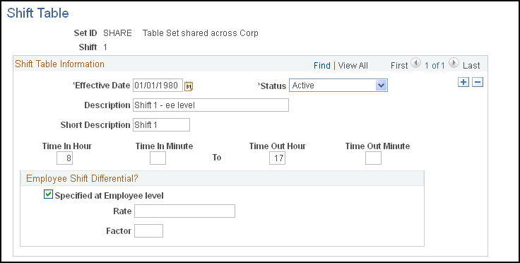

| Time In Hour, Time In Minute, Time Out Hour and Time Out Minute |
The time format uses a 24-hour clock, so if you're setting up a shift from 8 a.m. to 4 p.m., enter 8 and 00 to 16 and 00. |
| Specified at Employee level |
Select this check box if shift premiums vary from employee to employee. This enables you to define the shift premium rate or factor for employees assigned to the shift at the employee level. To define shift premiums at the employee level, use the Shift/Rate/Factor fields on the Job Data - Job Information page. |
| Rate |
If you didn't select Specified at Employee Level, enter the rate. |
| Factor |
If you didn't select Specified at Employee Level, enter the factor. |
