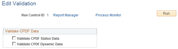

Use the Edit Validation page (RUNCTL_FGCPDF) to generate a table of the CPDF edit errors found in the CPDF Status and Dynamic tables.
Navigation
Image: Edit Validation page
This example illustrates the fields and controls on the Edit Validation page. You can find definitions for the fields and controls later on this page.
Field or Control |
Definition |
| Validate CPDF Data |
Select Validate CPDF Status Data orValidate CPDF Dynamic Data to create the respective files. |
| Run |
Click this button to process CPDF edits. |

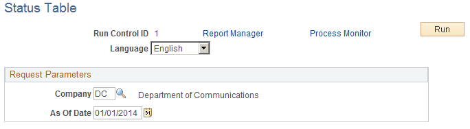

Use the Status Table page (RUNCTL_FGHR019E) to generate the Status working table containing employee information.
This is eventually used to create the Status submission flat file.
Navigation
Image: Status Table page
This example illustrates the fields and controls on the Status Table page. You can find definitions for the fields and controls later on this page.
You must first generate the Status Table in order to perform the CPDF status edits processing. Generation of the CPDF Status table enables you to run the CPDF edits process against the table and create the CPDF status submission.
Note: This process deletes existing data in the CPDF Status table before adding new records. If the organization needs to retain and save existing CPDF Status table data, you must back up the table before running this process.
After running the Edit Errors process, the working file contents can be viewed online using the Query Manager.
See Viewing CPDF Processing Results Using the Query Manager.
Field or Control |
Definition |
| As Of Date |
Select to restrict your selection to those employees active on that date. |

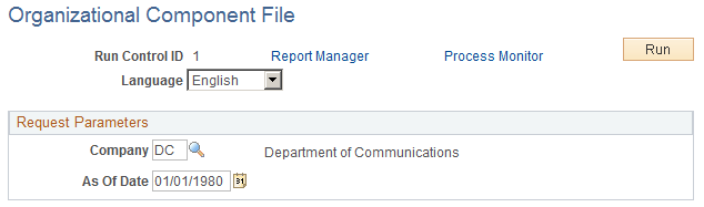

Use the Organizational Component File page (RUNCTL_FGHR019D) to report on codes, titles, and hierarchical relationships for organizations within an agency as of the end of the reporting period.
Navigation
Image: Organizational Component File page
This example illustrates the fields and controls on the Organizational Component File page. You can find definitions for the fields and controls later on this page.
The CPDF OCT consists of codes, titles, and hierarchical relationships for organizations within an agency as of the end of the reporting period. The OCT is reported twice a year, in March and September, and must match the organizational component codes used in the employee records in status submissions for the agency.
You must have already set up agency and language parameters before using this page.
Field or Control |
Definition |
| As Of Date |
Select so that the file contains organizational components that are effective for a given date. |
