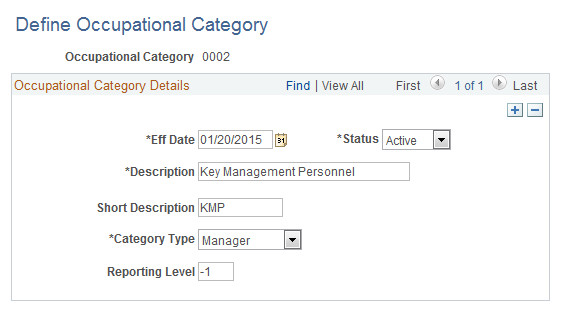

Use the Define Occupational Category page (OCCUP_CG_AUS) to define the occupational categories for managers and non-mangers.
Image: Define Occupational Category Page
This example illustrates the fields and controls on the Define Occupational Category page. You can find definitions for the fields and controls later on this page.

Eff Date
Enter the effective date of the occupational category.
Status
Displays the status of the occupational category. There are two options: Active and Inactive.
Note: Before making an occupational category inactive, ensure that there are no active employees mapped to it.
Description/Short Description
Enter the description/short description for the occupational category.
Category Type
Select the category of the worker. Value can be either Manager or Non-Manager.
Reporting Level
Enter the reporting level of the worker to the CEO. If the worker reports directly to the CEO, then his reporting level will be -1, and for each level below, it will be -2, -3 and accordingly. Reporting level is mandatory for managers but not for non-managers.

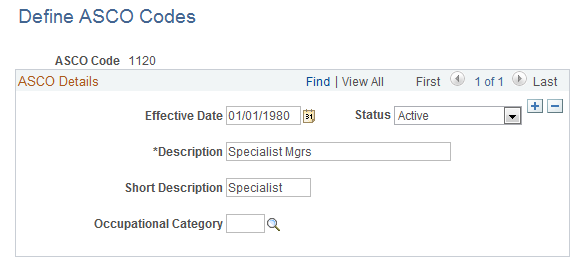

Use the Define ASCO Codes page (ASCO_TBL_AUS) to define occupational codes as per ASCO standard requirements.
Image: Define ASCO Codes page
This example illustrates the fields and controls on the Define ASCO Codes page. You can find definitions for the fields and controls later on this page.

Eff Date
Enter the effective date of the ASCO Code.
Status
Displays the status of the ASCO Code. There are two options: Active and Inactive.
Enter the description/short description for the ASCO Code.
Select the Occupational Category.
The WGEA reporting is done on the basis of occupational categories. Selecting the Occupational Category in this page, links it to the ASCO codes which are already linked to the job codes in the PeopleSoft HCM system.
